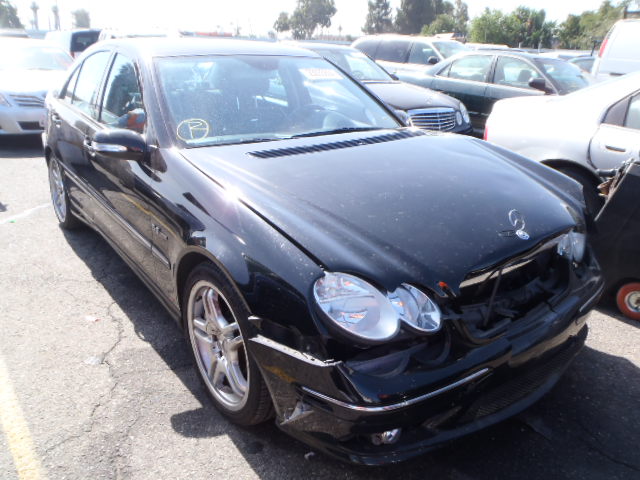

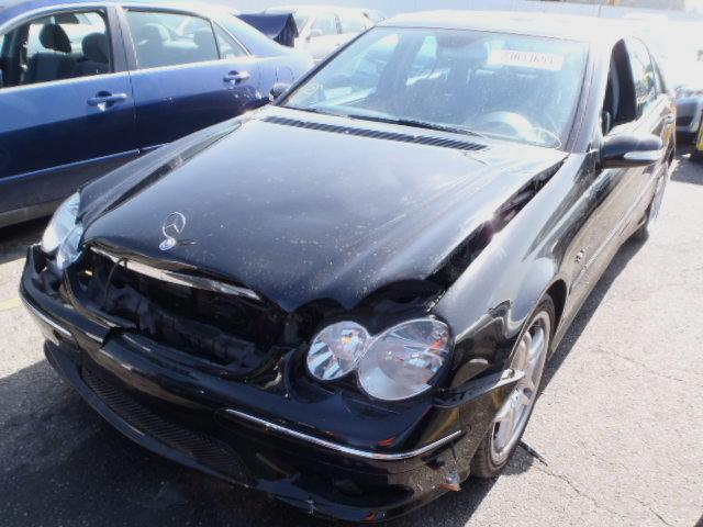

Hello everyone, I just purchased this C55, very low miles.
I was curious what do you guys think will need to be replaced other than the bumper?
Does the hood look broken to you?
Does the hood look like it has to be replaced? Notice the curve on the 1st picture, right of the left headlight
Thanks!

Bumper, hood, supports, radiator, frame, probably the fan and other coolers, headlights, and hopefully you can salvage the fenders. Hopefully there's no further damage, which could possibly total the car.
This doesn't mean very much - a real mechanic needs to look at it in real life.

Thank you, I hope it's not as bad as you say. It runs and drives, only 55k miles on it and I purchased it on an auction. It will come sometime next week and my mechanic will let me know what else is needed.

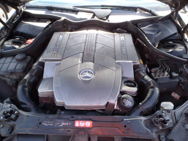

Here is also an engine shot if it helps

yeah, as viper said: just take it to a good mechanic before the body shop so you know there is nothing that warrants a total write-off before you fix the cosmetic bits. Looks like you will come out alright though. Keep us posted!!

Make sure your mechanic checks all of the front suspension. Mine was a salvage title and I've replaced upper and lower control arms, inner and outer tie rods, steering rack, strut mounts, and all bushings.
Do all of your fluid flushes too, tranny, coolant, brake fluid.
Those intake tubes look bent way back from where they should be. Like Viper said, definitely all of the supports, and make sure you check the subframe although the pictures look like it wasn't too hard of an impact.
