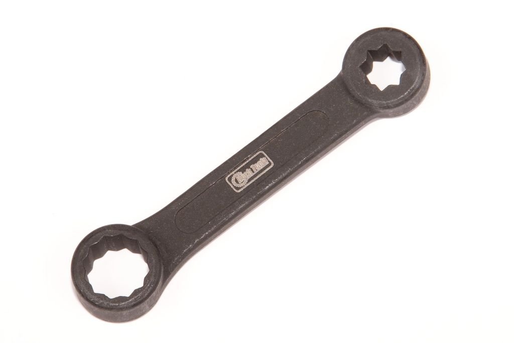

For the driver's side mount, I removed the front sway bushing brackets (E12 socket). For the passenger side motor mount, I removed the down-pipe and mid-pipe section of the passenger side exhaust (driver's side on a US or LHD car). I had purchased the Koch tool for the top motor mount bolts and it really worked very well.
It would have been very difficult without this or similar. To use your socket driver on this tool and get the right reach, you will need a couple of 12" 3/8 drive extensions or similar.
