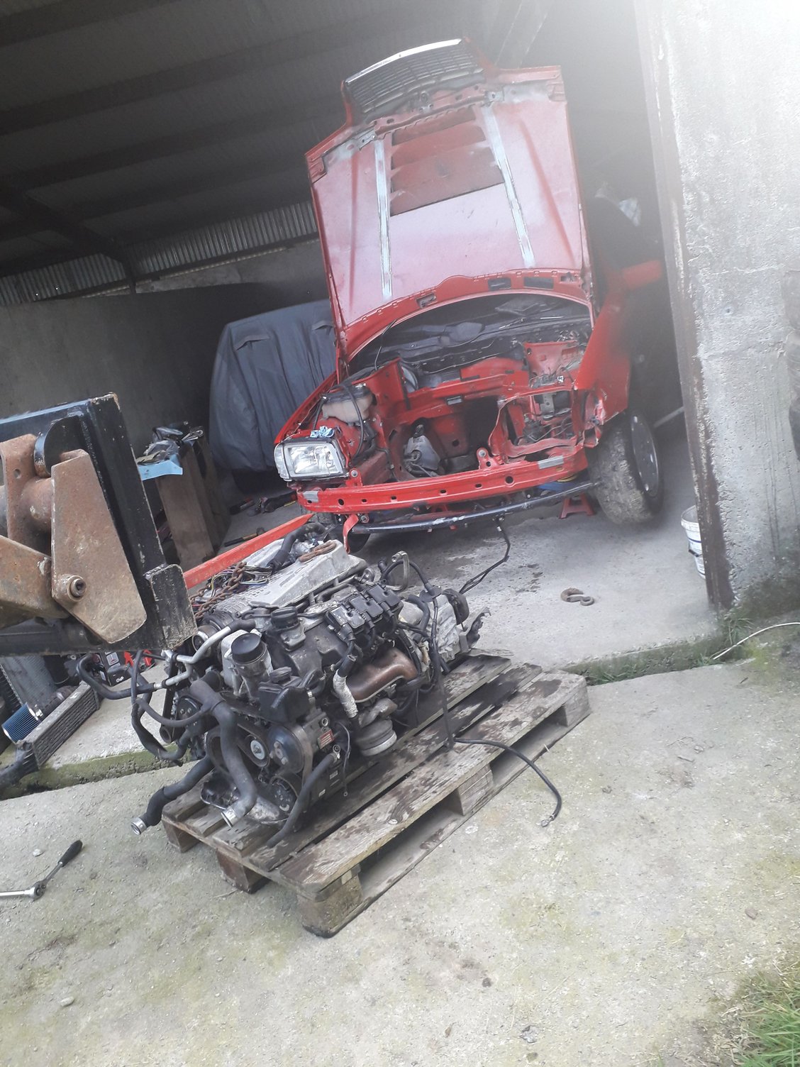

Hi everybody,
New to the forum but not new to mercedes, been drifting ones for the last 3 years. I bought a c240 road car and swapped a c230 kompressor running gear into it 2 years ago. Been a great and reliable drift car for me but I was at the point where I was comfortable with the car, and got the notion that I needed more power. A c32 AMG conversion swap came up for sale and I took the plunge and bought it. I am currently in the process of swapping it into the car, have the engine and gearbox placed in the car. I also got the loom, ecu and key with the swap and have installed all of these in the shell also.
My problem now is that I cant start the car. The key wont turn. I think this is due to the fact that I don't have the steering lock from the car that the engine came from. As far as I know the ecu needs to get the data from the steering lock to be able to disable the immobiliser allowing you to turn the key, and because I don't have it it wont let me turn the key. I have tried getting in contact with the person I bought the engine from to see if he has the steering lock but I cannot get in contact with him.
So this is where I am stuck, I tried getting onto some local ecu tuners about removing the immobiliser system from the ecu, but they all say that the immobiliser cannot be removed or disabled. The next thing I am thinking of trying is getting a steering lock from another w203 and coding it to the ecu to be able to disable the immobiliser- is this even possible?
Any help or tips with anything is much appreciated, I will post a few pics of the car!
