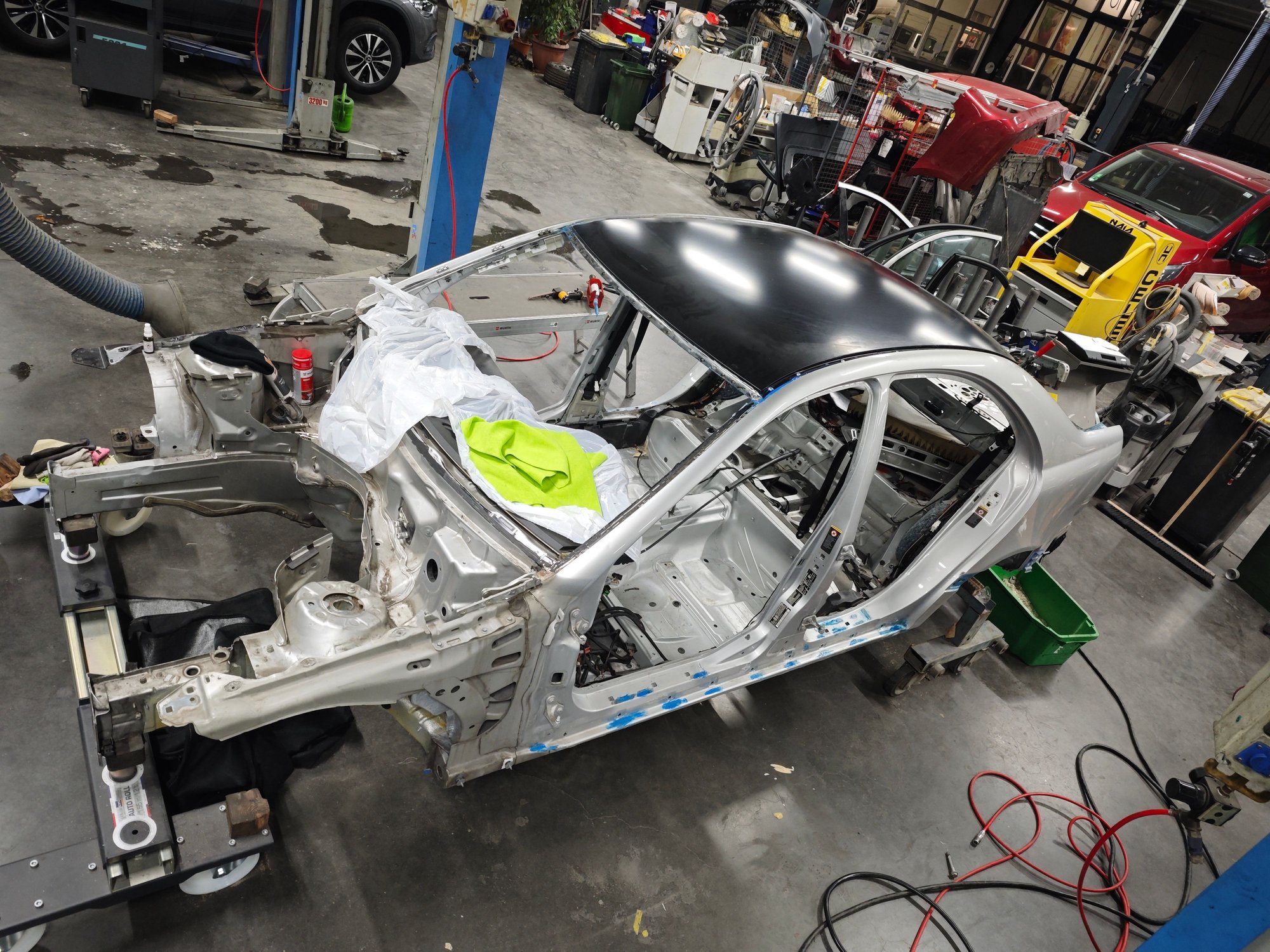

Old thread, i know, but i'm doing it currently

Where did you acquire the slick panel, used or new?

Ordered it from MB, there should be 17 left in Germany. There were 19, one got damaged during transport and the other one is on my car now
