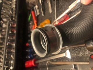

Putting a new lower coolant hose on, every other attachment seems to be hose clamp, what am I looking at here?

This part (metal) goes inside radiator hole and fixes with some kind of spring (a0079932801) above
