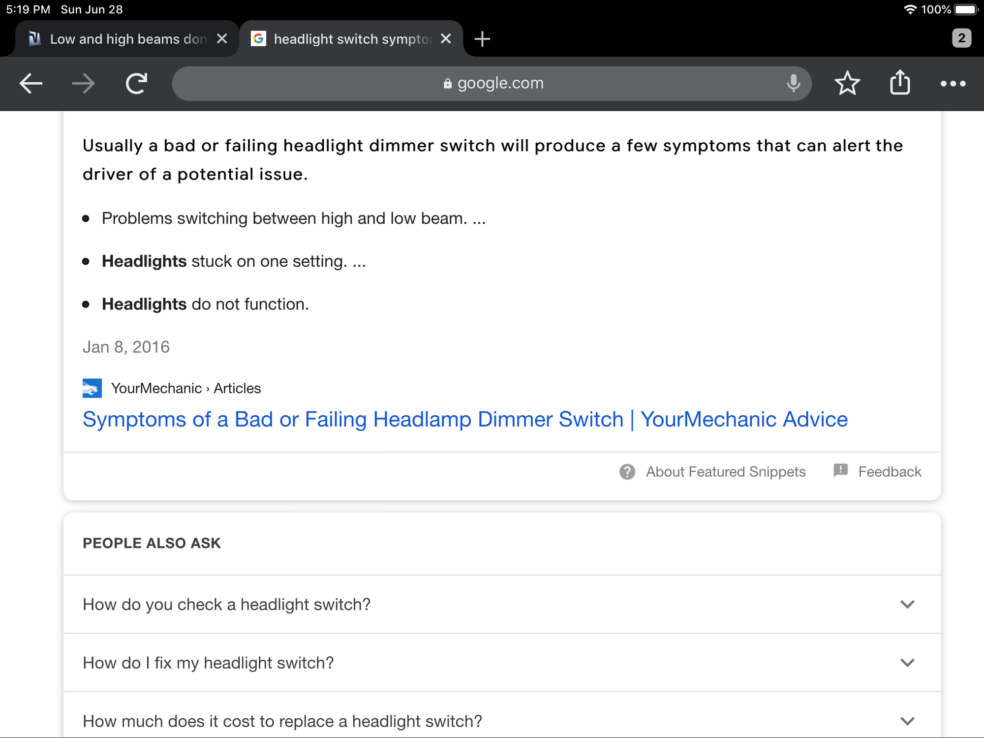

It sounds like a defective headlight switch. My old 202 had a faulty one which caused all sorts of issues with the lights. A relatively inexpensive fix and a good place to start:
GL.
