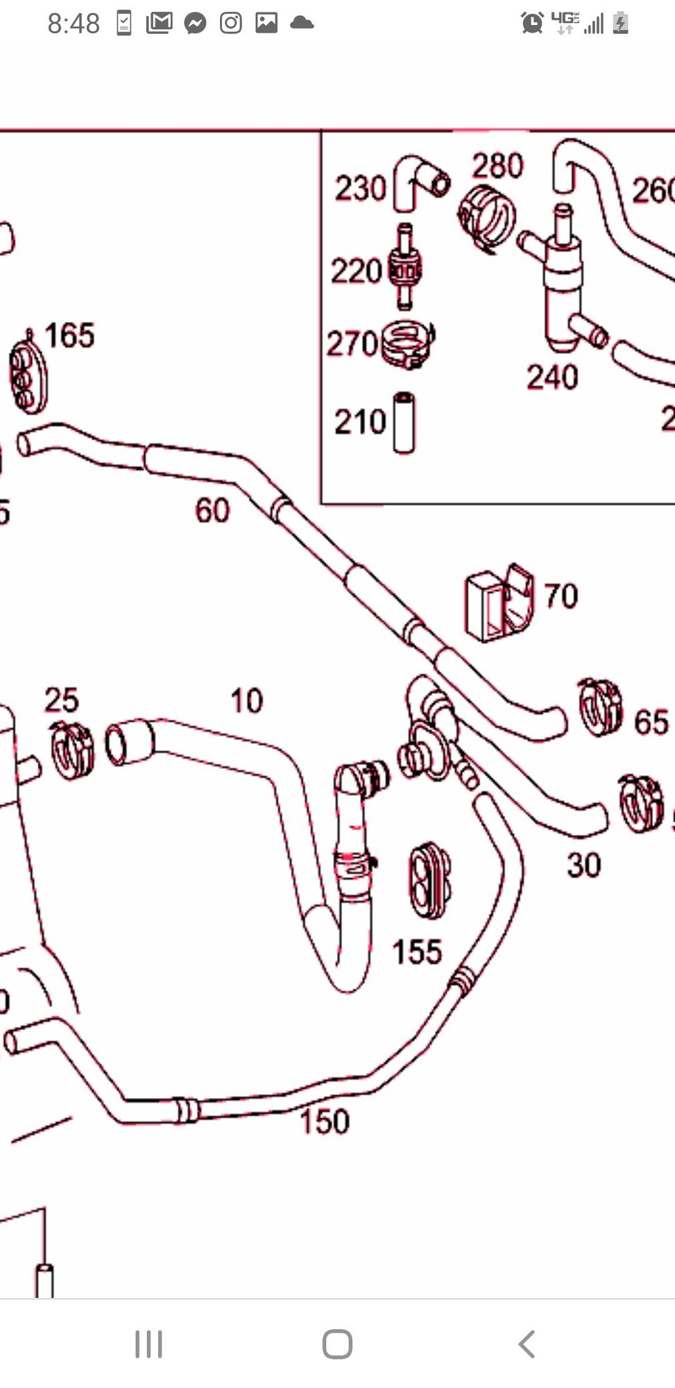

Thankfully it wasn't a heater core or a hose! It was however a fitting on the heater hose by the firewall and under the cowl. I might need help locating this part, so.... if anyone can figure out this part # it would be appreciated!

Looks like it might be Item #3
I think you're right! It looks like there are 2 separate parts when you're looking at it in front of you, but maybe thats just the way it comes?
