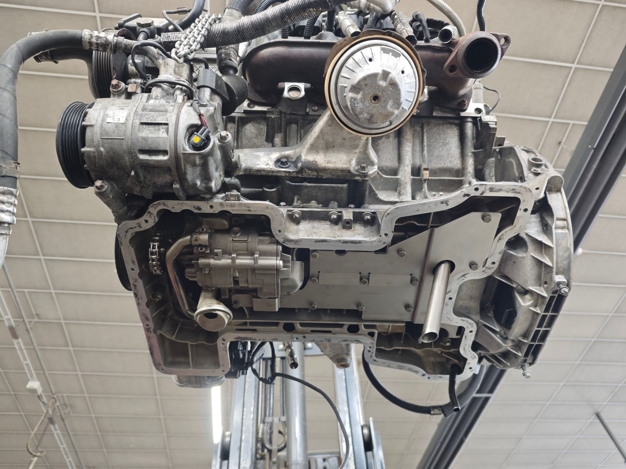

I serviced the engine, before installing it.Changed the rear main seal, valve cover gasket, changed all rubber hoses, swapped all spark plugs, resealed the lower oil pan and did an oil change. Compression across the cylinders were all fine and the o ring behind the timing cover was changed in 2018.

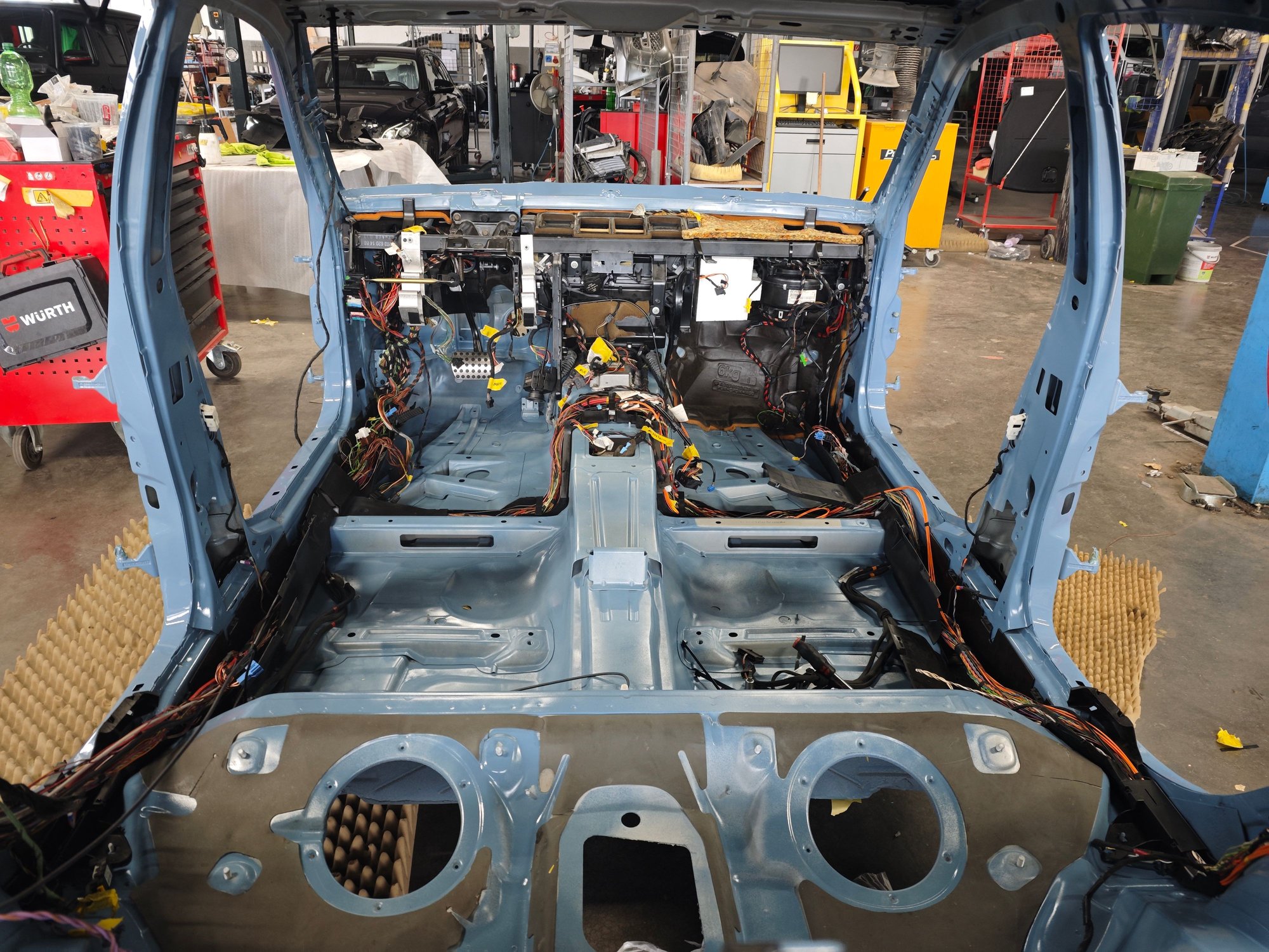

In July after the chassis was painted i stripped the interior, cleaned everything up and then sprayed it in china blue too. I wanted the car to be painted in blue, like it came out of the factory.
