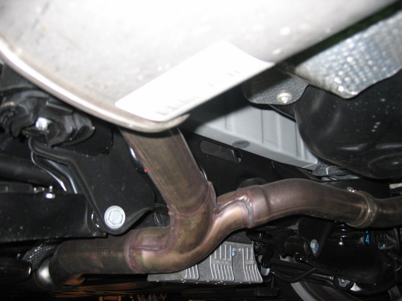

Where is Resonator
I got a clear bottom of my car
where is the resonator I can remove
follow the piping starting from right to left of the pic, when you hit that bulge where the heat shield is above (just as your pic ends), that is your resonator, the muffler shop will saw/torch it off and replace it w/ a straight piping...when you look into the resonator once removed, it'll look like a regular muffler from inside...like someone said on the forum before, it acts as a second muffler...hope this helps
