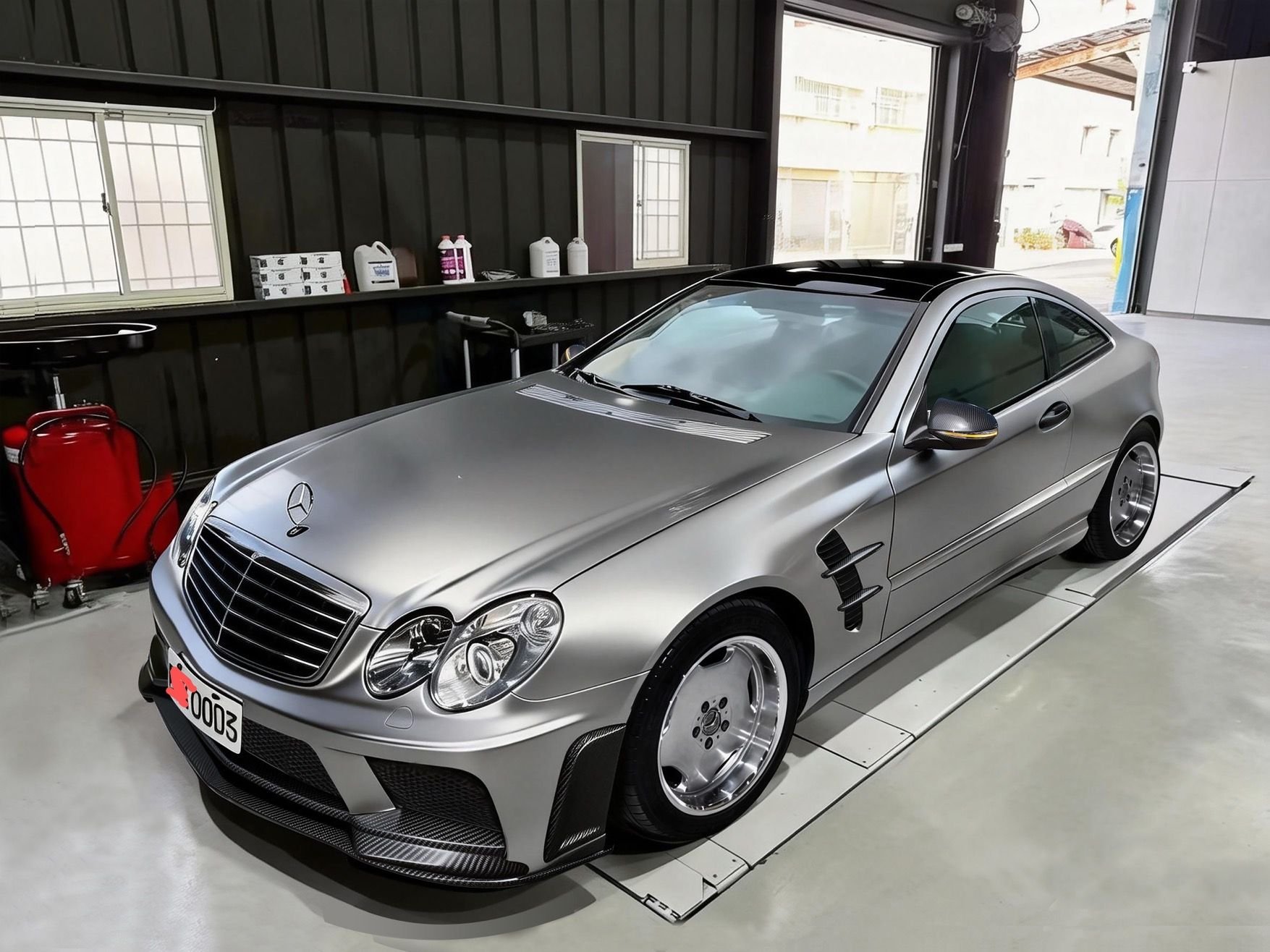

"When a boy lays eyes on a CL203 forgotten by AMG, and in turn, that CL203 sees the potential within that boy..."
Hello MBWorld Community 🤝🏿
After three years of quiet R&D and meticulous planning, I am finally ready to break the silence. This is more than a modification; it is a tribute to a "Classic Three-Door Hot Hatch" that Mercedes-Benz never truly unleashed to its full potential: Project "CL203 XX" AMG Restomod.
1. Structural Fusion: The V8 Frontend Swap
To accommodate the legendary M273 5.5L V8, my team and I have successfully performed a W203 C55 AMG frontend clip swap, extending the engine bay by precisely 82mm. By integrating the C55's structural architecture, we've created the perfect home for the V8 beast and its cooling system without compromising the chassis's original rigidity.
2. Aesthetic Evolution: W211 & W209 Hybrid Styling
We are redefining the CL203’s silhouette through high-precision 3D scanning and custom fabrication:
  • W211 Facelift "Pointed Hood": We are remodeling the front fascia to introduce the iconic W211 facelift aesthetic, featuring a custom integrated hood-and-grille opening mechanism.
  • OEM+ Fender Arch Grafting: To ensure factory-level precision, I have ruled out aftermarket flares. Instead, we are harvesting OEM W209 CLK63 fender sections to be precision-welded (grafted) onto the body. This provides the necessary flare for wider rubber while preserving the crisp, authentic AMG lines of the early 2000s~
