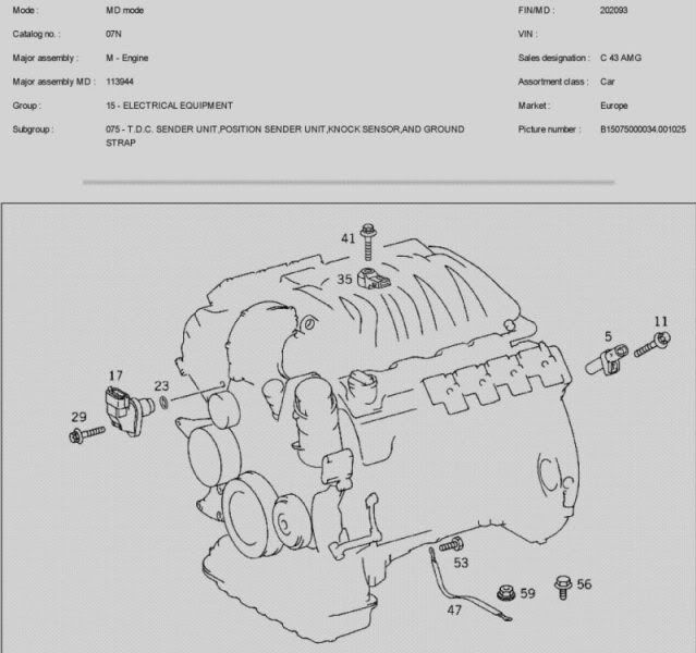

Anyone got any good guidance on where the crank position sensor is located and is this a simple replacement with standard tools?

STF.....search the forum......back along the firewall..where the motor and tranny meet.

My security clearance has been revoked as well.
CPS is #5:
Part number –
003 153 95 28 up to engine # 60 002420
003 153 96 58 after engine # 60 002420
