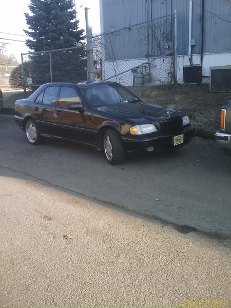

Talking BLACK GRILLE-C43 WHAT DO YOU THINK!?
C55 engine swap or supercharger on stock C43 engine? and where can i get the supercharger from? BLACK GRILLE-C43 WHAT DO YOU THINK!?-securedownload.jpg
