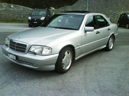

Purchased a C43
Well I picked up my C43 AMG this afternoon. 1999 model, silver, black leather. Two previous owners and 200'000 km. Goes like a train and the sound when accelerating is like a symphony. A real wolf in sheeps clothing. Purchased from a MB dealer after full service. Has some small surface rust, but nothing important. Will give further details after having driven it some more and do some detailing. Probably will also do the ECU reset trick this weekend and see how it goes after that.
See you all.
