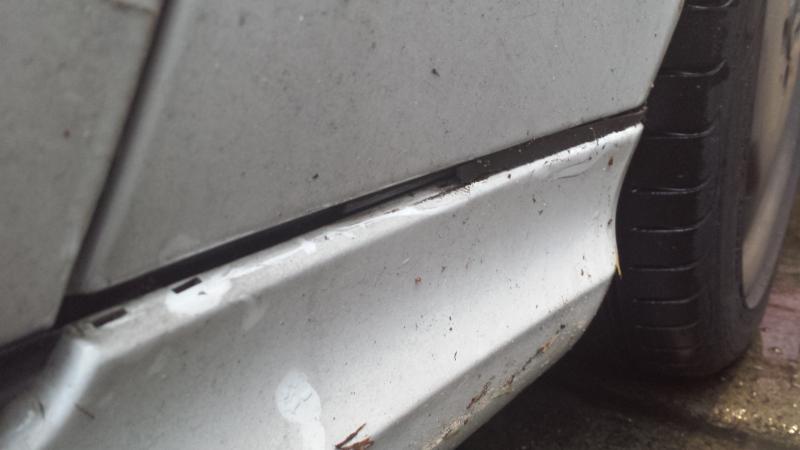

Hello everyone, I was wondering if anyone knew where I can buy some some seals for the side skirt front area by the jack up port. Here's a picture of the seals for the driver side.

Call the dealer. theyre super cheap bruh. These are the MSRP prices, meaning actual prices fro dealer. if you get discount you will know now for sure.
FROM MODEL YEAR 1998 $15.50 2026984130 LEFT Forward side.
FROM MODEL YEAR 1998 $15.50 2026984230 RIGHT Forward side
FROM MODEL YEAR 1998 $6.50 2026984530 LEFT Rearward side
FROM MODEL YEAR 1998 $6.50 2026984630 RIGHT Rearward side

Thank you so much man for info. Is it easy to take the old seals out and install the new ones?

To install the new seals you must remove the side skirts. There are fasteners along the bottom of the skirt, behind the seals and in the door openings. IIRC, on the C43 the ones at the bottom are the expanding rivet type. I can't recall how to unfasten the ones behind the seals. To pop the fasteners in the door openings gently pry up the skirt in the door opening. Work slowly and gently.
It is a good chance to wash the inside of the skirt and the body behind the skirts.
