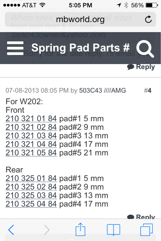

Does anyone know the rear spring shim/pad size 9mm 5mm?????

Sir, a gift from our MIA friend Jason.
Edit- stock was a 9mm number 2 front and back on my 97 c36. If your curious to know what pads your running take the wheel off, get a flash light and look up the side of the spring to the pad. On the out side of the spring pad facing down will be little bumps/nipples that poke out. How many are there will correspond to the pad number.
B

Someone correct me if Im wrong but I believe its 9mm all around.

On mine (European version) it had #1 front and rear.
