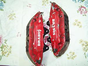

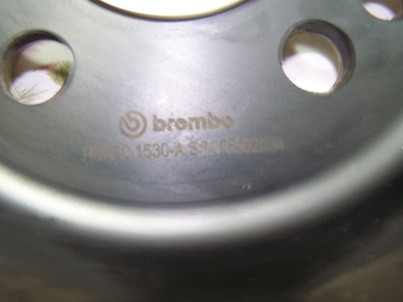

Guys,
My friend found an used upgrade Brembo brakes, he removed them from 1998 W140 S600, Rotors are 355x30,
i assuming they are some kind of Brembo GT upgrade, any clue..!?!

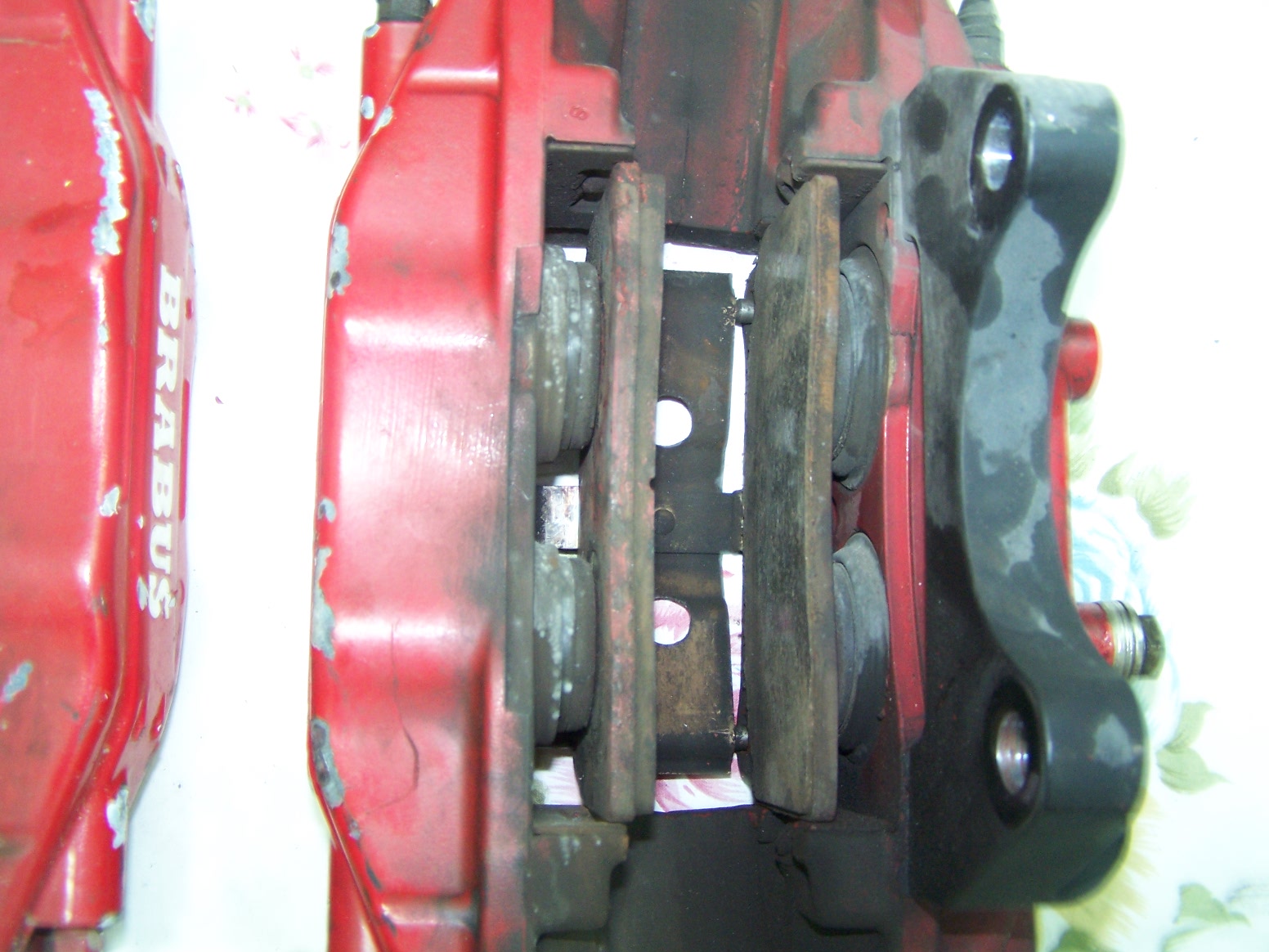

The pads are cooked!

Pay Attention with the rotation on calipers. There should be printed the piston dimension somewhere... the first piston in wheels rotation must be the smallest.
