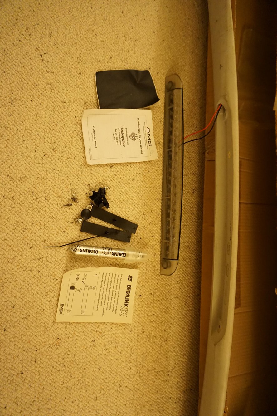

I found an original amg spoiler in Malaysia... Unfortunately the sealant has used by date 2000. Did anybody notice the LED light is made in New Zealand?..nothing is made in NZ haha, this has travelled along way to get back home.

Yes definitely geniune and good find,it was listed online but photo was incorrect however part number lined up perfect,i got them to send through actual photos to confirm. I payed 190nzd (about 150usd)
It comes with original amg installation instruction in german with install drawings, the vynel is to cover the third brake light but i think i will just remove it from parcel shelf
Also comes with sticky locating pads so you know where to drill!

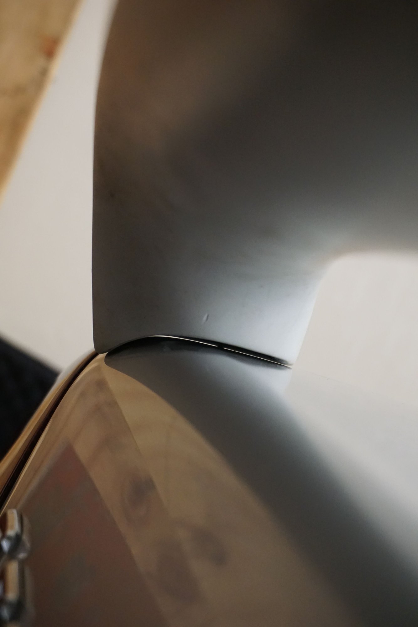

Guys,
There is an interesting fault with this spoiler, for the light fitting to sit correctly, and for the spoiler to mould to the boot shape, it needs to be pressed down in the middle a little,maybe 5-10mm... this is why the spoiler on the damaged C36 I posted did not sit right, because if either of the fixings comes loose then the spoiler will "lift" on that side and look uneven. Also, pressing it down makes the spoiler slightly wider and lines up with the boot better.. I wonder if pressing and adding a little heat would permanently correct the problem?, the spoiler looks like it is fibre reinforced plastic.

Hello Tony,
Here's a photo showing fitment, the outside edge follows the shape perfectly however the inside edge sits lifted, when the fixings are applied this would pull down ok and the spoiler height would drop in the center however it would be a much better install with no pre-tension, I guess maybe this was due to heat and storage ..but the C36 I viewed earlier had same issue!
The locating pads are plastic with sticky back and locate into the screw hole like this,you then remove the spoiler and drill through the locator on the pad.

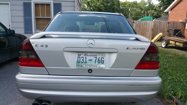

My lorinser bootlid spoiler fits like a glove! too bad it has no 3rd light

Attached. It's in bad need of some touch up work. It has a few chips in the fiberglass that need repaired and then a repaint.
