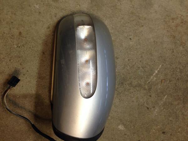

2003 c240 Mirrors Fit C43
Guy is asking 150 for both. Will they fit?

From research I had done a few years back I believe they will bolt up but sit at the wrong angle...your car will have mirrors like airplane wings tilted up. I have seen the W210 mirrors on ebay for $100 each effectively $60 more for the set. The W210 mirrors will bolt right up, lie correctly and have a bodyline crease in the mirror cover line up with the one in the door. In both cases you will need to do some wiring as that part is not plug and play.

Thank you very much for the info!
