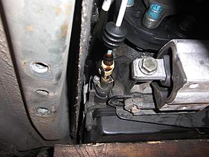

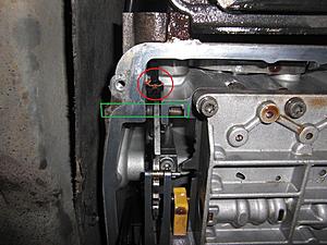

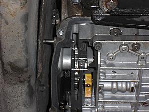

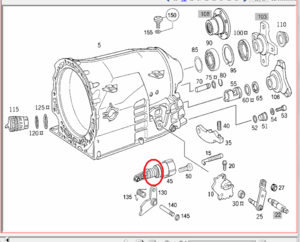

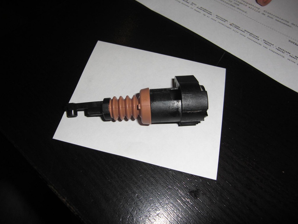

i also had a leaking transmission on my C a while back.
seems this part was fauly. ( see pics below with the fix.)
