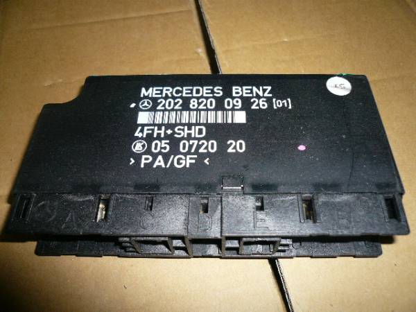

Using STAR will help a lot to see what's the fault stored to the ECU, and prevent spending time & $$$..!,,
is your can has this comfort module..?, if so, it could be something wrong with it..!!
Attachment 313241
ZAYED,,
yes, all US w202's have this module.
I had MAJOR problems with this module in my 1994 C280 when the trunk flooded with water! But I don't think i have issues with it now. With my old car, even with this unit disconnected I could still operate locks, blower, etc. As far as I can tell the comfort module only controls window motors, sunroof, and the auto-up/down feature when you press the 2nd "click" on each button.
the fact that I now have issues with multiple other systems not related to the comfort module leads me to believe my comfort module is fine. I also had very short range on my keyless prior to this week, and now my keyless isn't working at all. I suspect it's a DCM failure.
