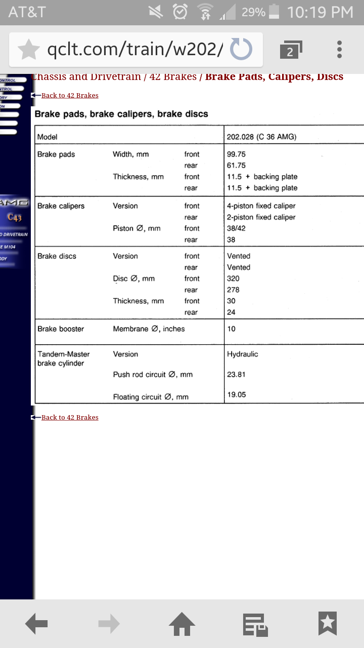

Does anyone know the diameter of the front rotors? I know they are keyed for each side L/R, from an SL series.
Is it 334mm or 335mm?
Also is the nominal thickness 32mm?

Here you go man
Attached Thumbnails Front Rotor question???-screenshot_2016-12-20-22-19-38.png
