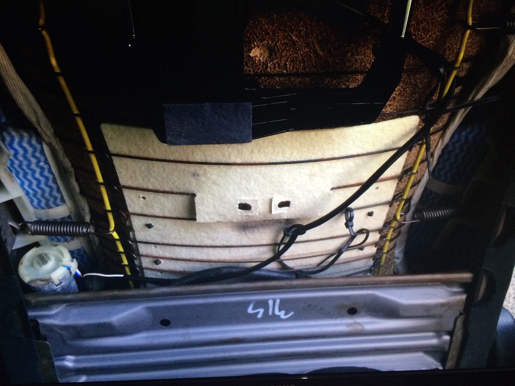

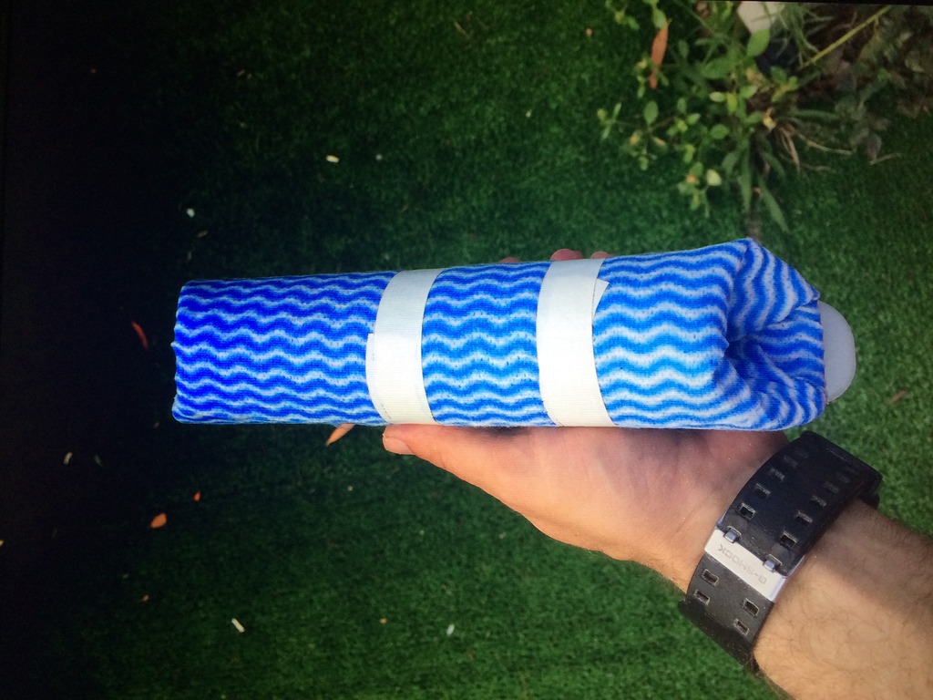

Ok, ive come up with a working solution...
From my previous career as an electrician i have loads of tools and still had some stuff laying around, 50mm underground conduit is what i used:
Cut it all to fit:
Screwed in place with some big hex head metal teks:
Unscrewed it and gave it a nice soft coat:
Installed them back in the seat:
The finished product, nice and snug:

Im not sure how far the bladders pump up, but it is probably pretty close to 50mm, the seat is now very snug, which i like. Seems pretty close to how they were at full inflation.
Fitting them back in was a fair task, but if you get the angle right they go in ok without too much effort.
My back now fits nicely against the lumbar, and the bolsters stop basically all lateral movement.
