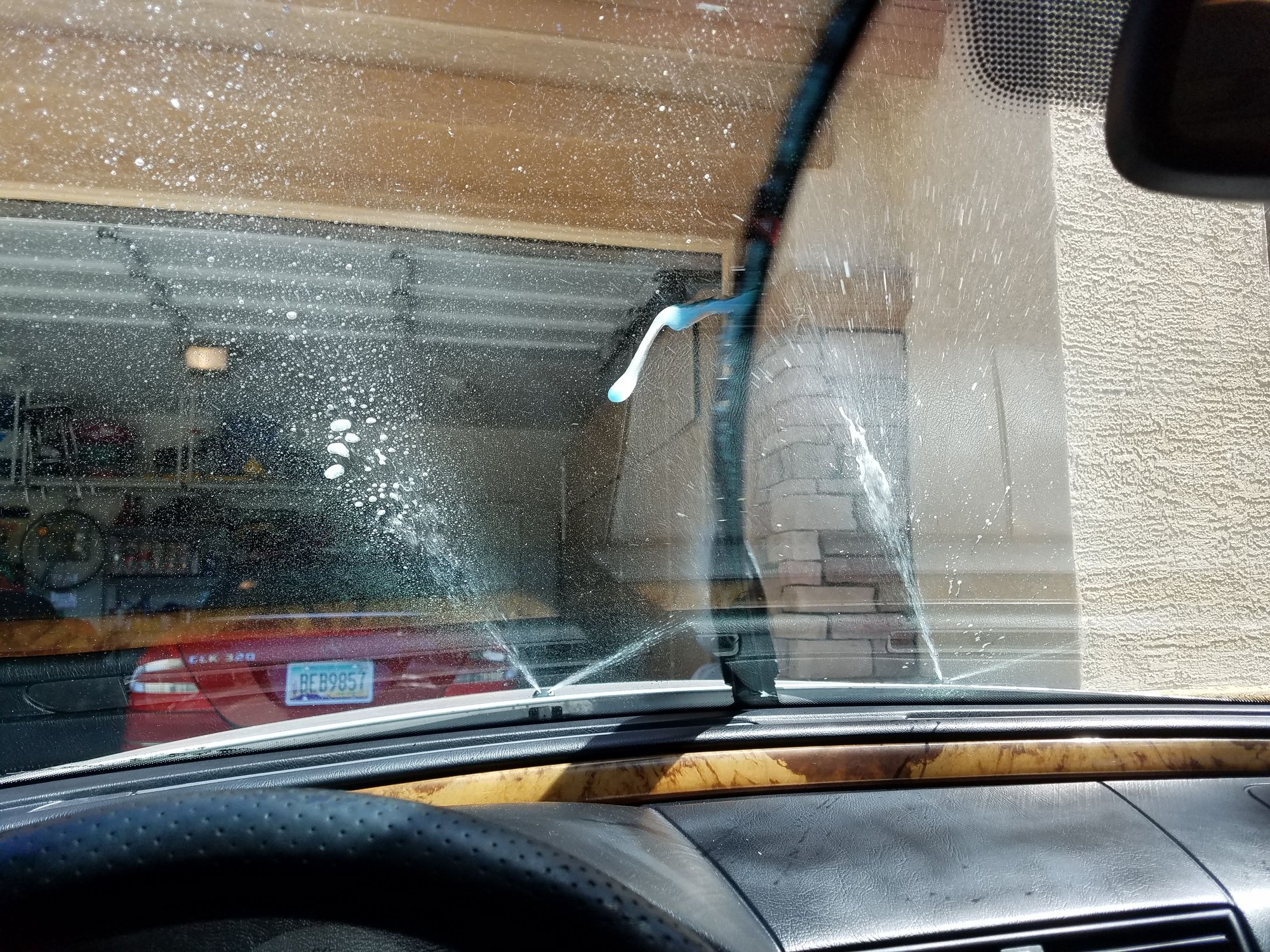

My 1998 C43 windshield washer was not working so I replaced the pump. Good flow but it was leaking at the check valve where it splits to he headlight washer. Replaced the check valve and now it does not leak but when I press the windshield washer button the fluid goes to the headlights. Strange. TIA.

Problem solved. Some P.O. swapped the lines. I switched them back (with help from my assistant) and voila.
