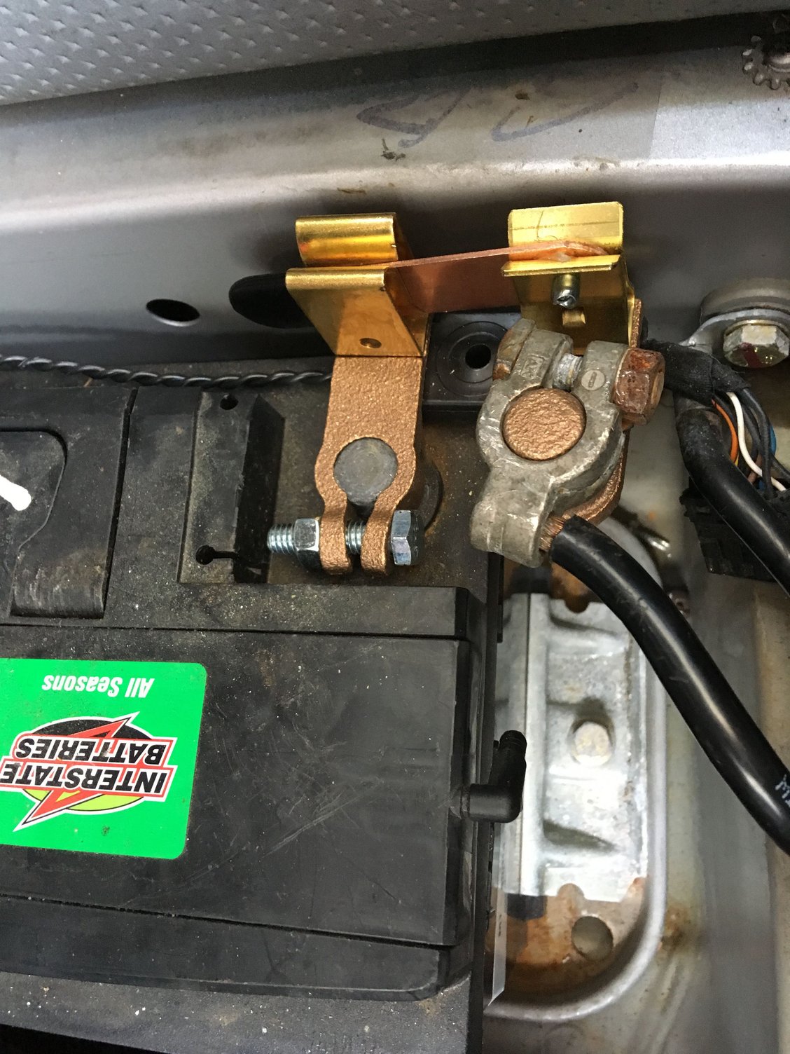

After reading about the window issue some of us have with our w202s ,I added a quick reset latch to the negiitve battery terminal
i cleaned the front vent drain by the passenger side firewall which was clogged with dirt , and water was leaking in after heavy rain or after I’d wash my car .
I noticed the rug was getting wet , but once I cleaned the drain the water issue was resolved , that’s knew I noticed my front window or sometimes even
the righrt side mirror wounldnt work .Reset the computer was a quick fix disconnect the negative cable for 30 senconds to a minute and all
was back to normal
So every now and then I just do a quick reset and it’s good as new .
