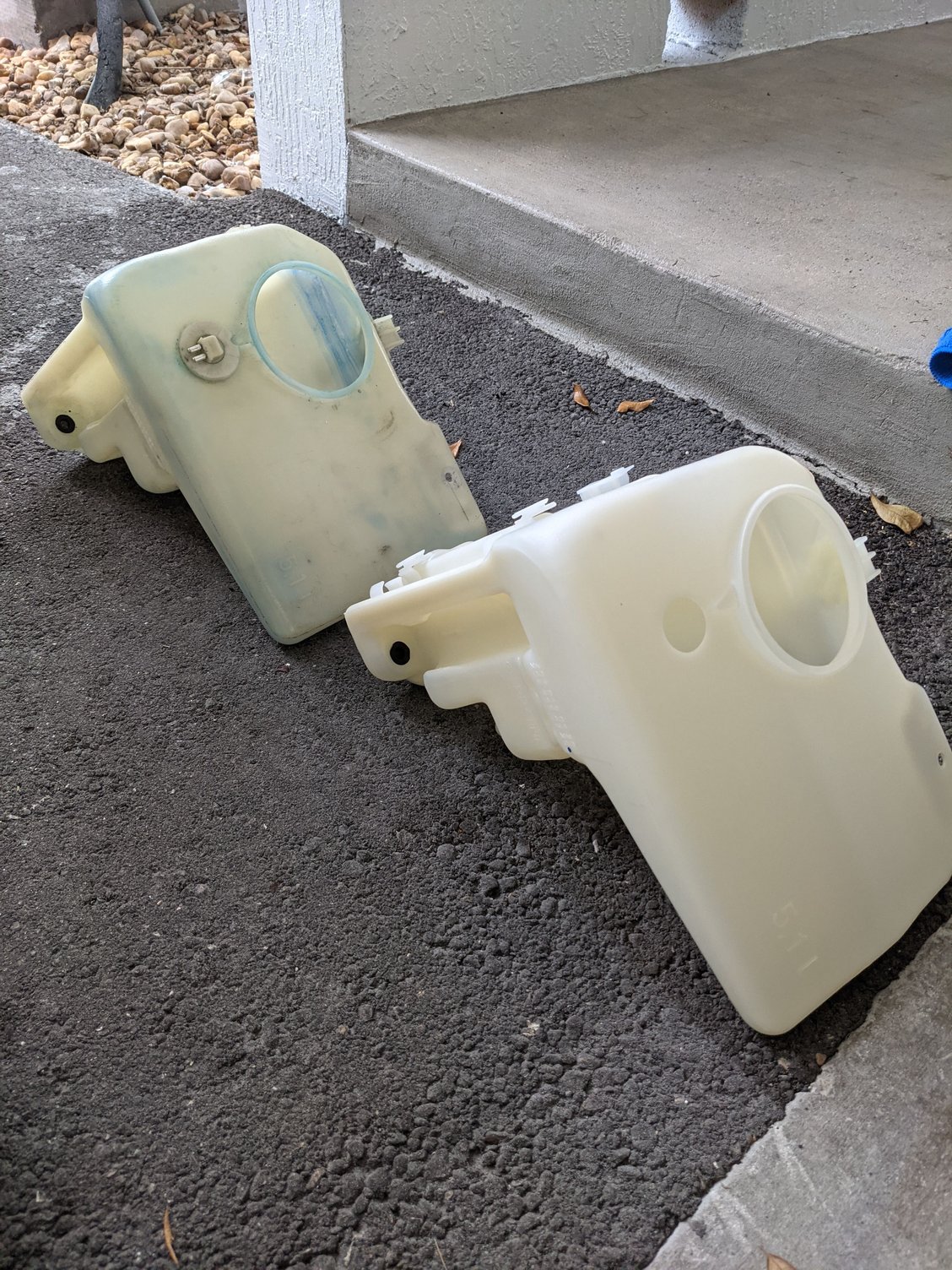

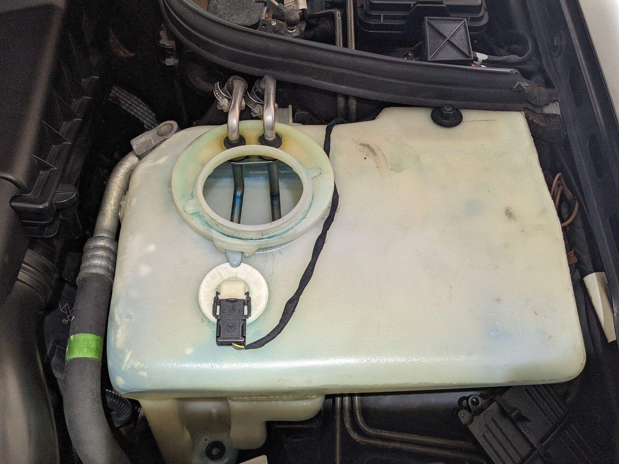

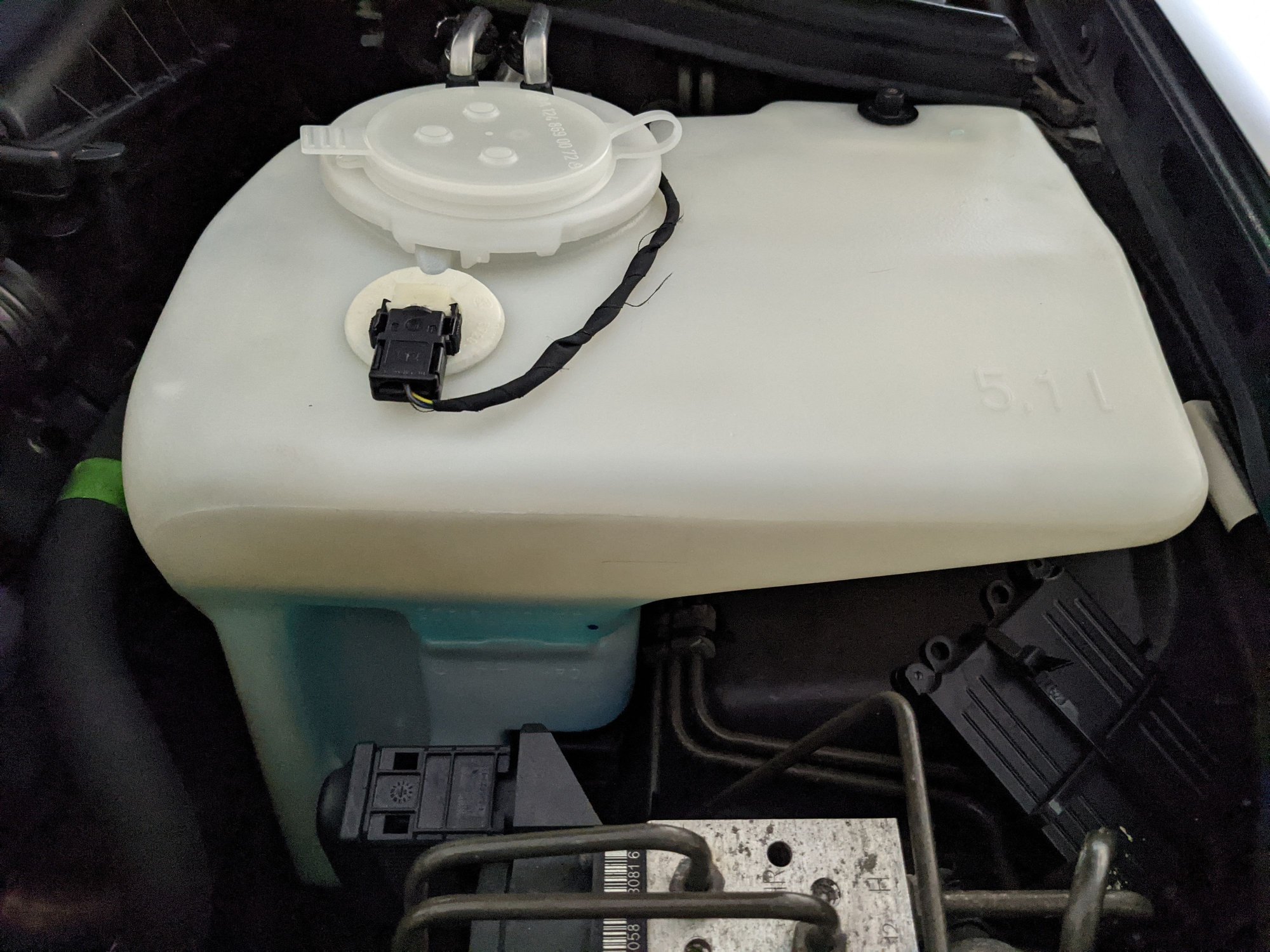

    Some pics of the process.
  16. New plug (this is where headlight washer pump would go; would need a gasket instead if you have one).
    Fluid level sensor (with gasket on it).

Restoring the car and the tank plastic was stained with blue dye, dirt, plastic yellowing (as evidenced in one of the pics where I compare old vs new tanks). Also a lot of the plastic and rubber was brittle.
