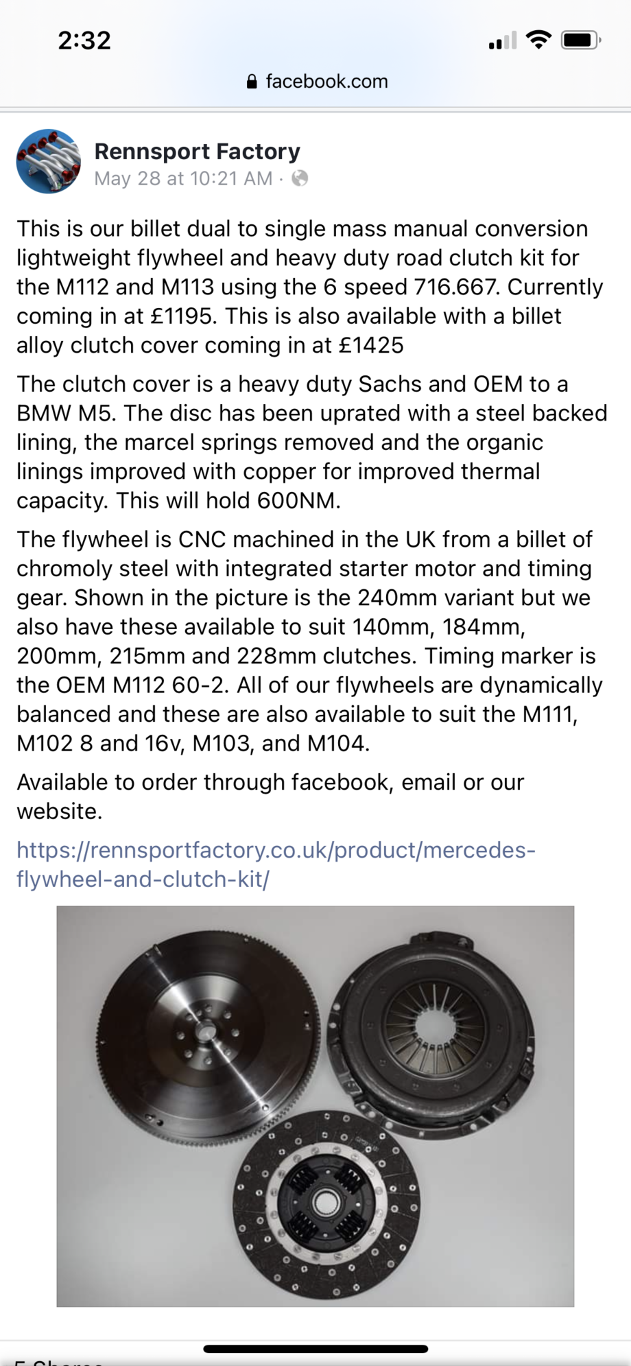

Have you looked into these guys yet? https://rennsportfactory.co.uk/
They’re not cheap but you’ll get a bespoke clutch/FW kit for your Mercedes manual swap.

I did see this, total of like 1400.00 without counting shipping. Im going to look into this. The luk flywheel and clutch purchased separately is a little cheaper. These things are definitely not the easiest to come across on the web.
Thanks

I know who rennsport outsources his production of flywheels to. I can hook you up with the exact same billet flywheel for less than what rennsport charges - and to whatever weight you want. Send me a pm.
If anyone's interested in a group buy, I could probably get a good deal. Put your name down in this thread. If there's enough interest I will get the ball rolling.
