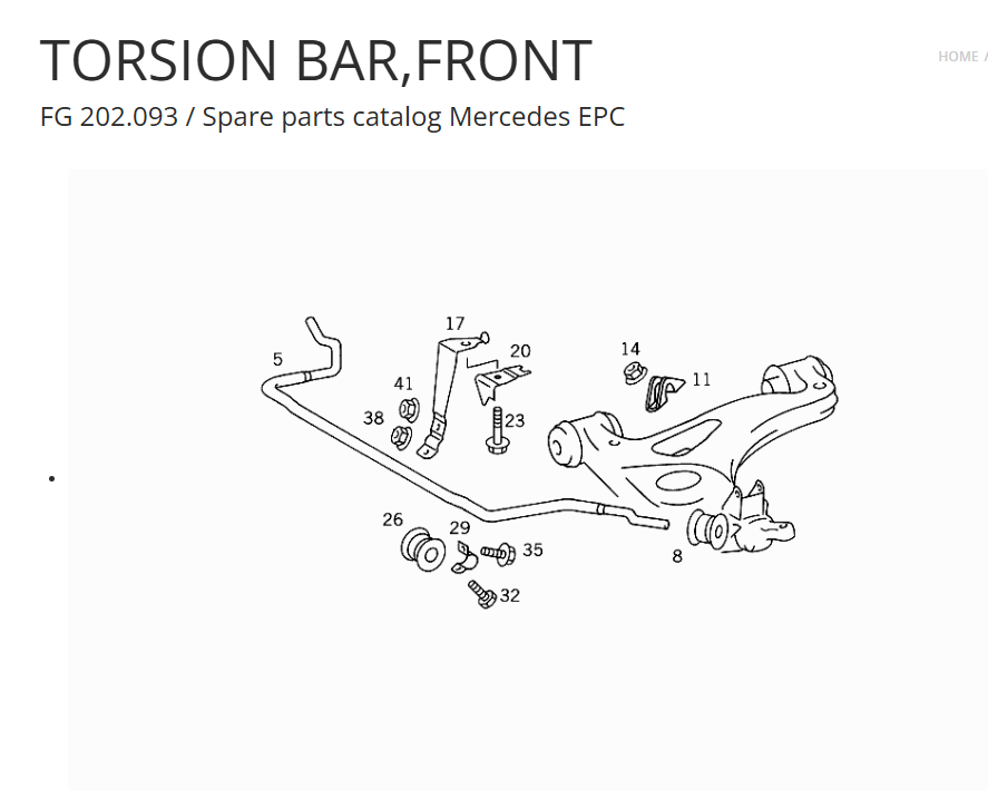

The cause of noises can be tricky to track down. Last fall I was hearing a clunking noise on my passenger side when going over bumps with the drivers side front wheel. Jacked up the car and started grabbing things trying to rotate/twist/shake to reproduce the sound. Turned out to be the passenger sway bar link which I had replaced two years prior. Seems the movement of the drivers wheel going up and down transferred thru the sway bar as it should and the passenger link was worn.
I was looking thru W202 parts diagrams and looks like the sway bar bushings are replaceable, Lemforder brand only $3/each.

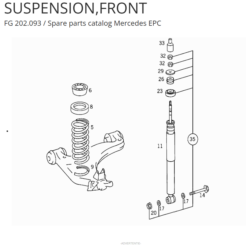

Also noticed the shims at the top of the springs. Wondering if they are similar to the rears on the w204 where they fit up inside what looks like upside down metal bowls, they can crack and may rub around .
