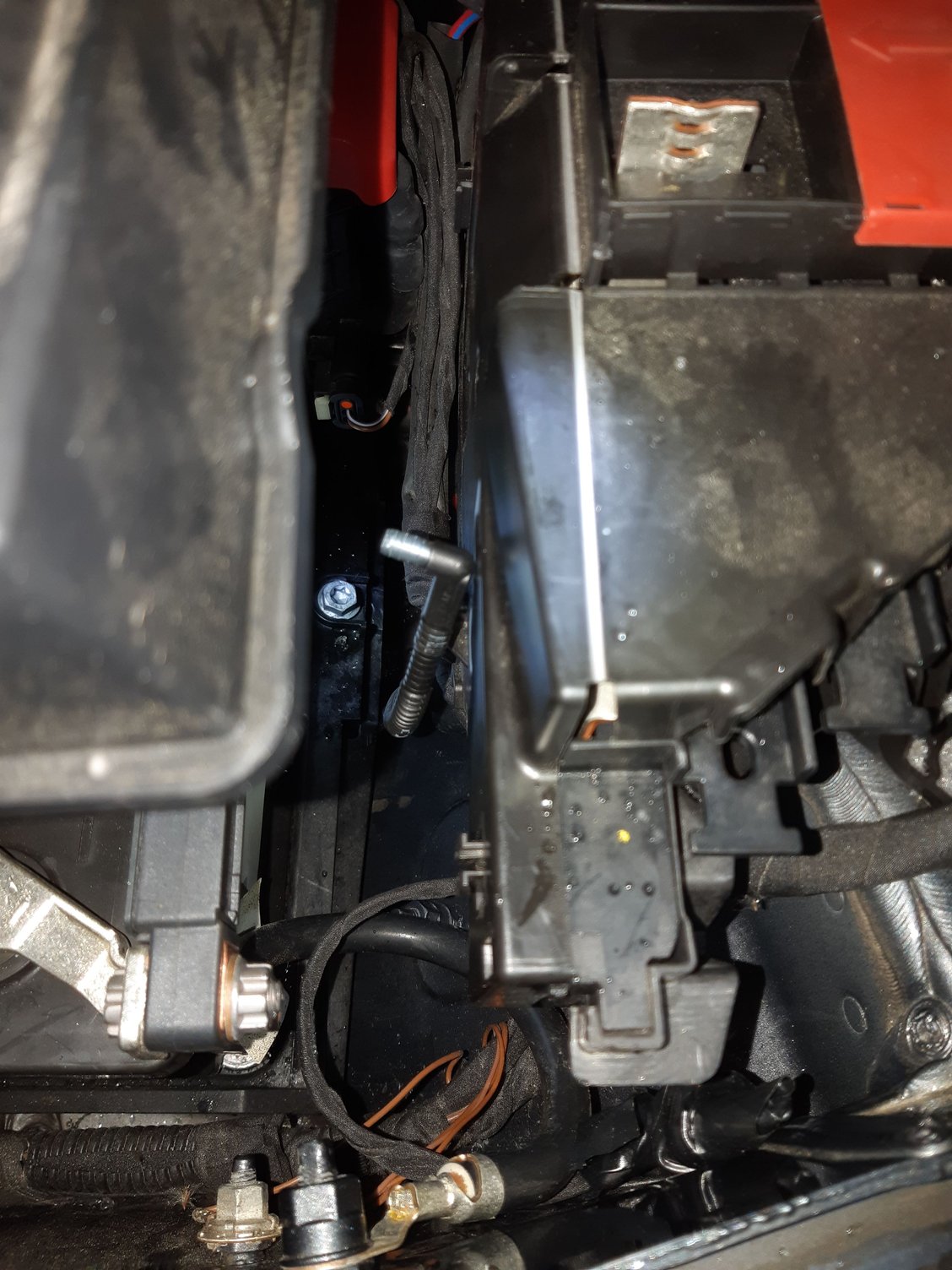

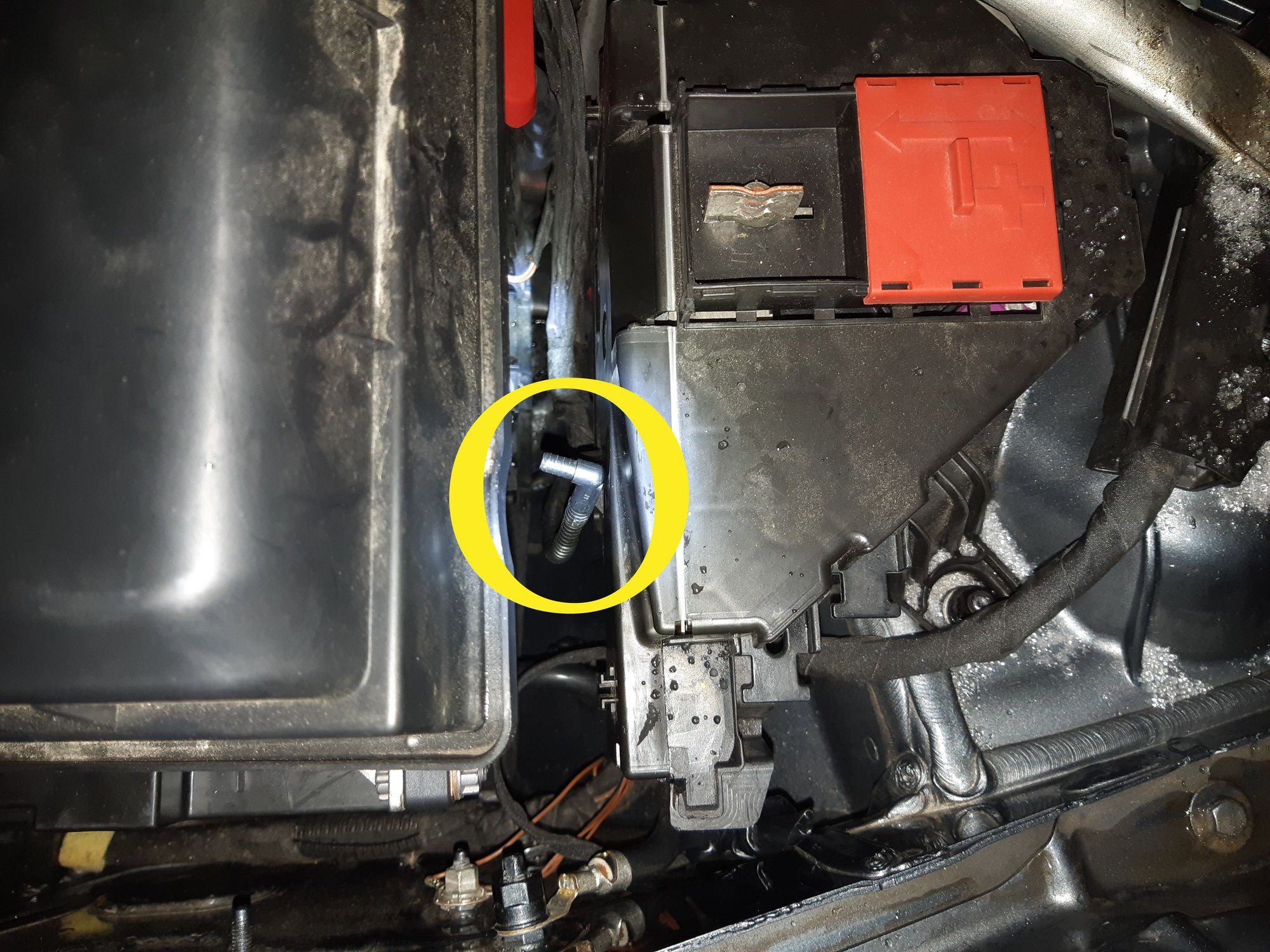

Anyone know what this hose suppose to connect to?
Looks like some kinda vacuum hose. I had the battery warrantied last month but found this hose hanging around the area.
Thanks.

Looks like the battery vent hose.

Is it suppose to dangle like that? Where can I secure it to?

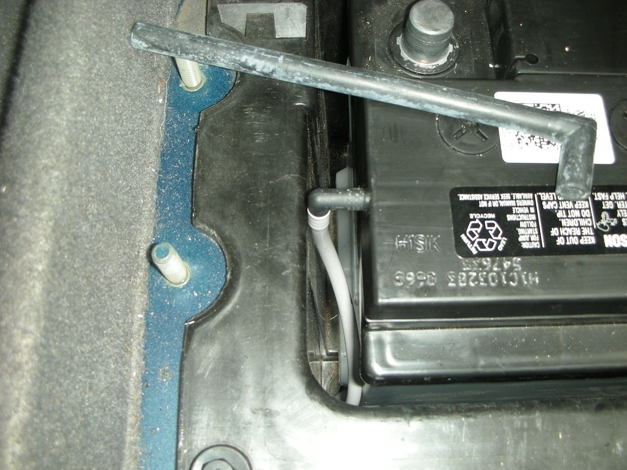

Pull the cover off for the battery. You should see a port you can connect the vent hose to.
When they swapped out your battery, the tech probably just forgot to connect it.
I've attached a picture for reference. (not our car platform though)
