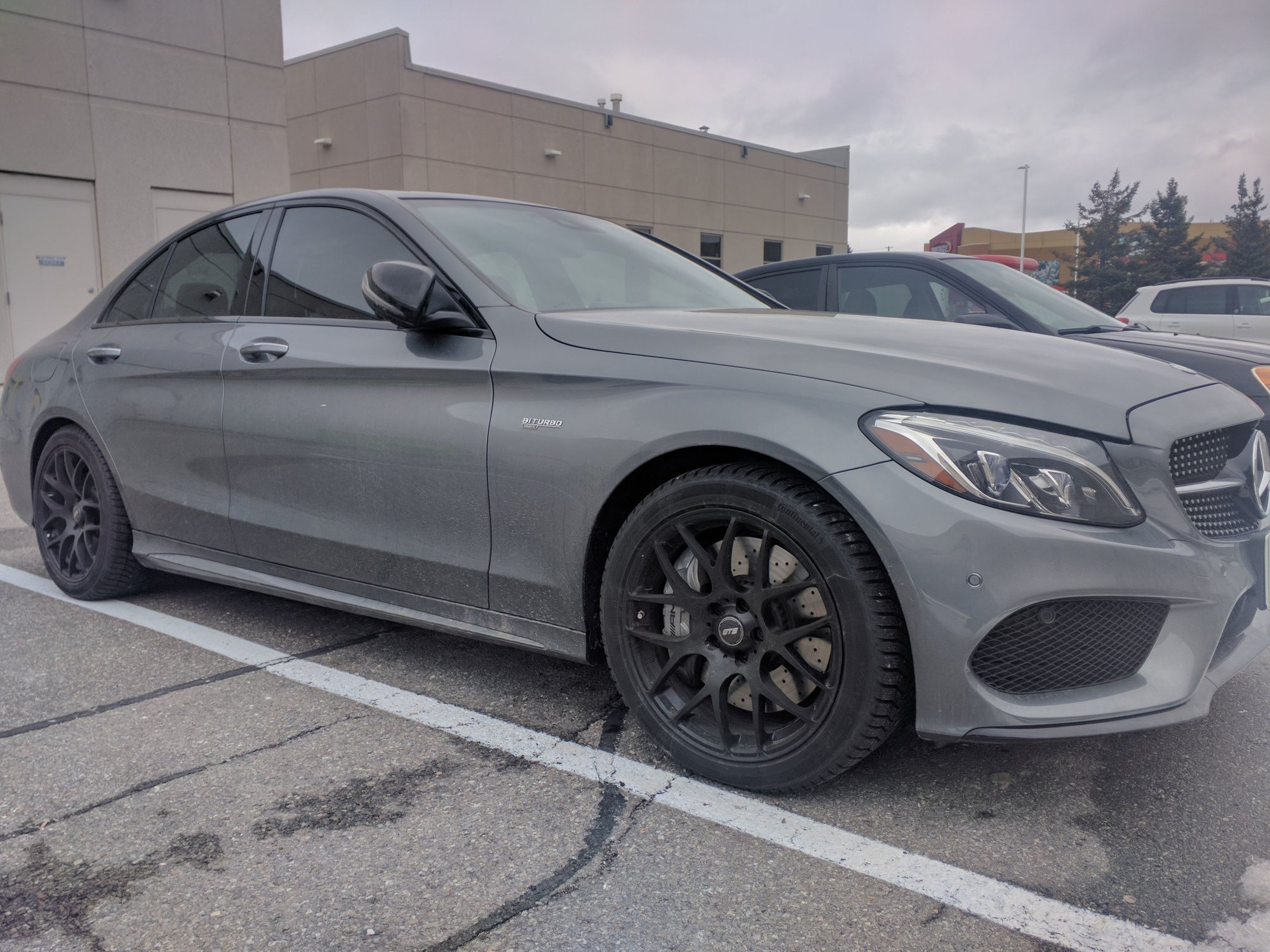

For winter, I am running 18x8 35 offset all 4 corners and they are pretty flushed. Any 5mm more out, you might rub your fenders.

Conti winter contact si 225 45 18
