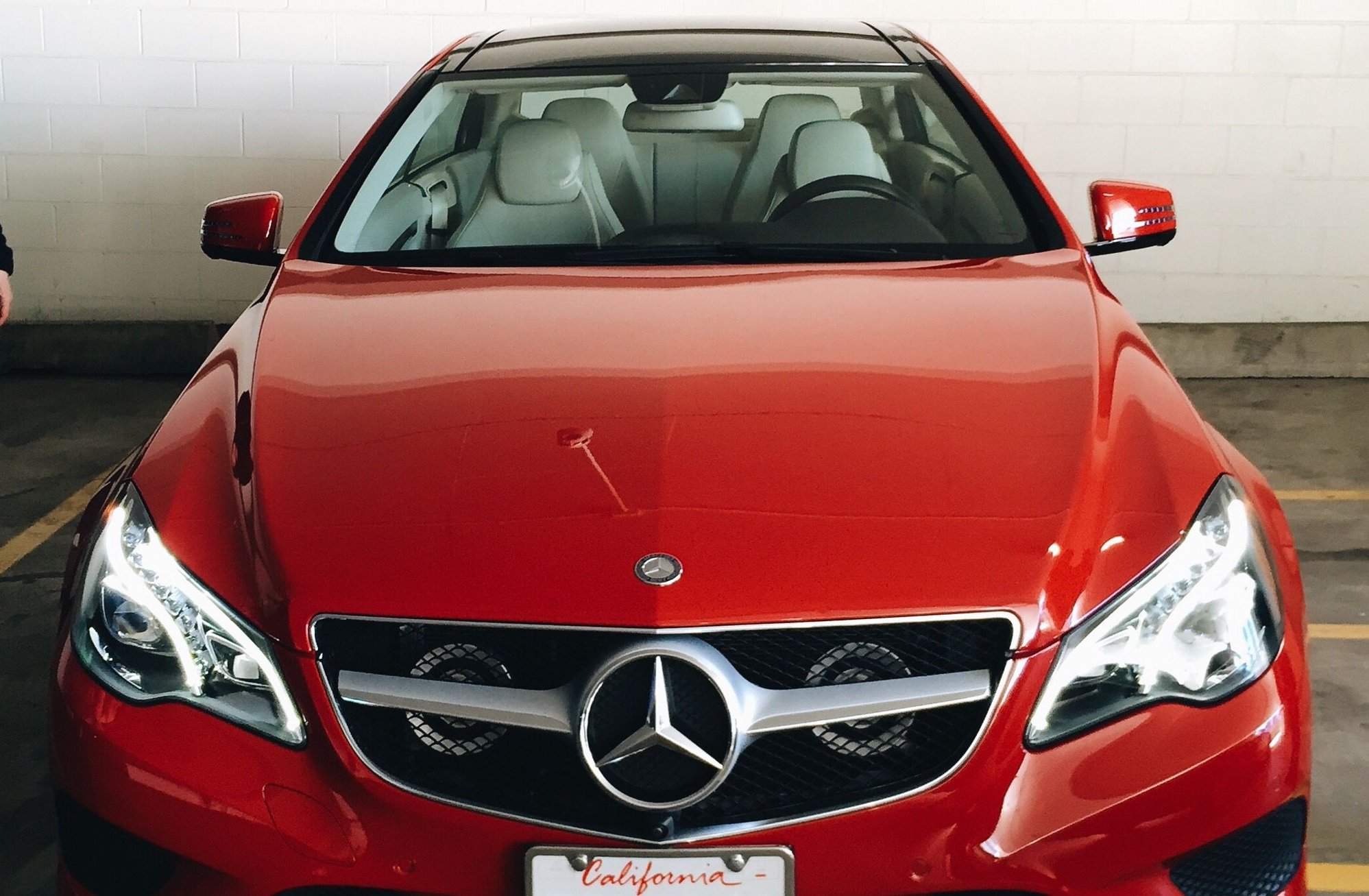

I replaced mine with Bosch Europa horns that I installed in my previous e-class coupe.
Unfortunately, I didn’t wanna go through the hassle of removing the front bumper to access the front grille of the c43. So, I just installed it behind the front outer grille which is where the original horns were located. I did it by peeling back the inner fender liners.

Wow these are huge compared to the stock snail horns!
