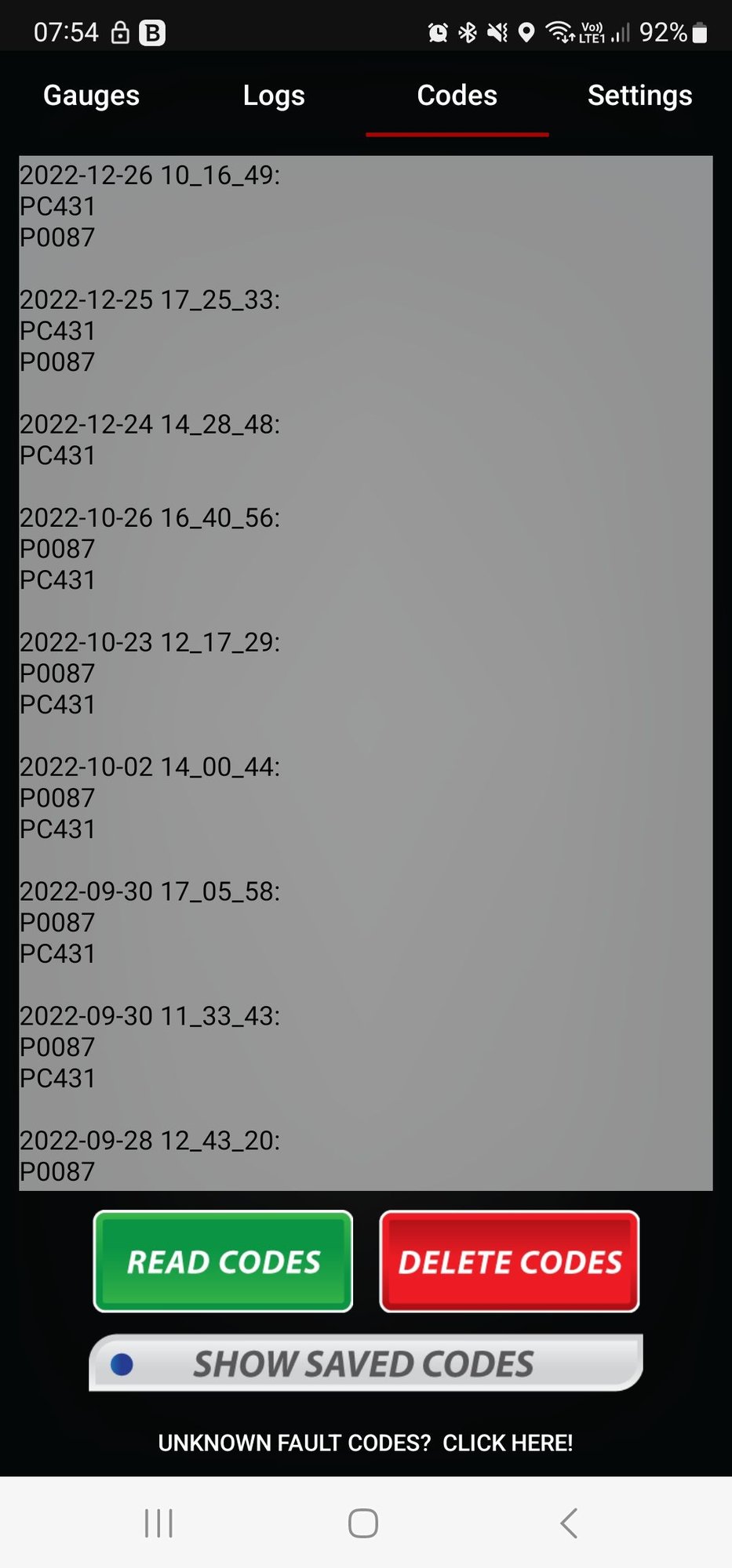

I purchased a JB4 Bluetooth kit for my 2016 W205 C43 a few months back and had it installed.
The problem I seem to be having is, regardless of what map I try to use (1-3), if I give her a bit of a tickle on the freeway....my engine light comes on, it goes into limp mode and I get the following 2 codes come up on the JB4 App.
P0087
PC431.
Is anyone able to give me some guidance as to what issues im having here and possibly point me in the right direction to get it working properly.

I think one code is “fuel pump “ something do u have a full tank? Going up hill?
I had a setting that was too high and burger looked through the logs and had me change

I recently had a P0087 code as well.
Its from low rail pressure from either low fuel, too much E85, having FOL setting too high, or too much boost in cold weather.

Got P0087 from WOT on Map 2. Went away the first time after a restart. Got it a second time and stayed. Ended up having to take it to the dealer and they replaced the fuel pump. No issues since.

I had this too but I was low on fuel and going up hill
we adjusted one of the settings on jb4 and haven’t had issue

Fuel Open loop
but u should email Bms and they will work with u
