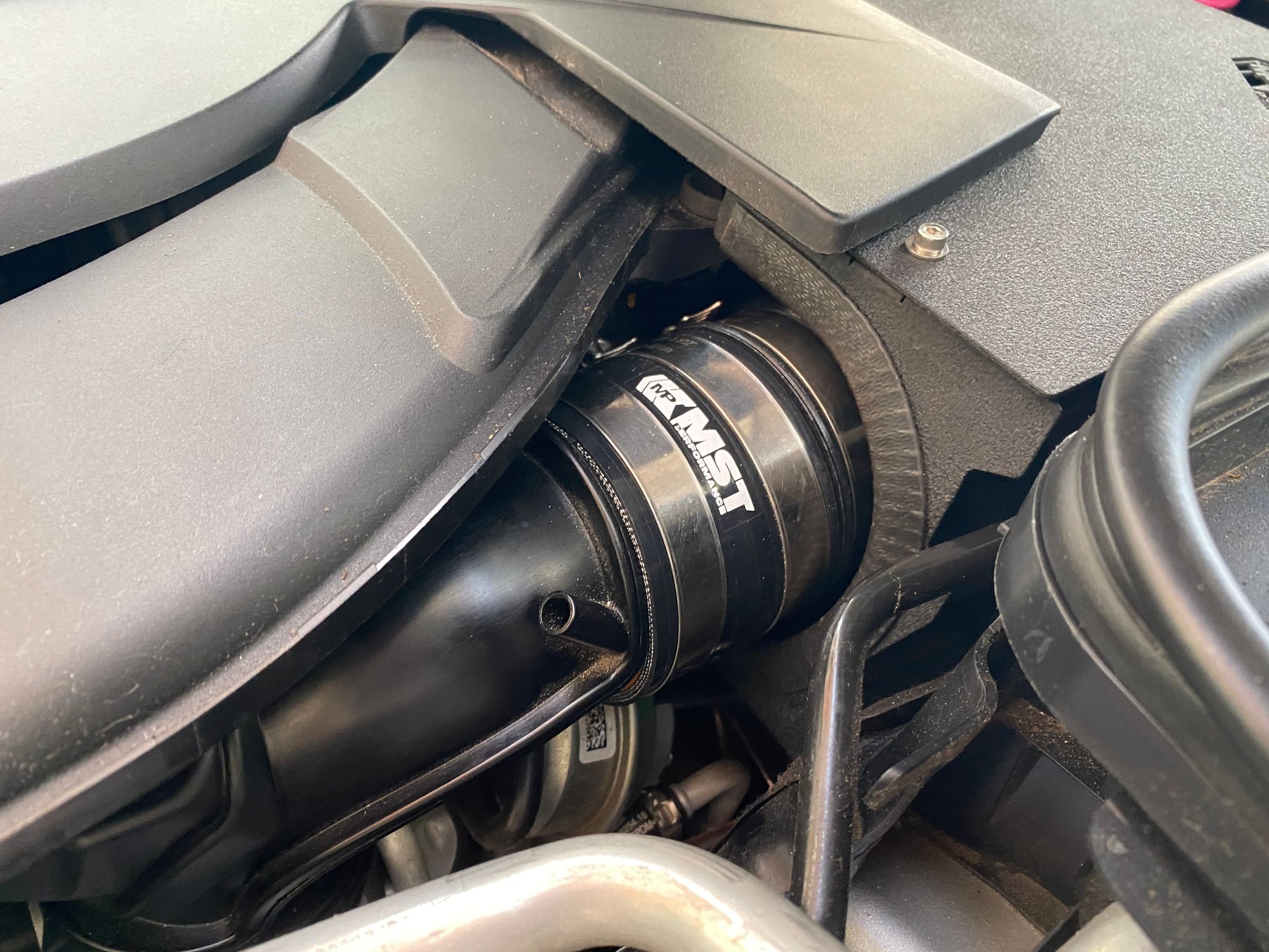

Yeah man.. get it tuned by Eurocharge and go with the MST 2.0 cool air intake system with the bigger intake tubes. I makes a huge difference for sure. The JB4 is a good and less pricey tune, but if you want it to be bad ***, go with Eurocharge. I had JB4 and noticed a difference, but it was like night and day between the JB4 and the Eurocharge. I was told to never mess with the exhaust by an exhaust expert because it’s not worth it unless you want your car to sound like the idiots on the fast and furious lol.

Gotcha, mine requires the CPC tune as well since its 19+. Do you have any experience with the BMS intakes or was the MST 2.0 perfect for you first go around?
