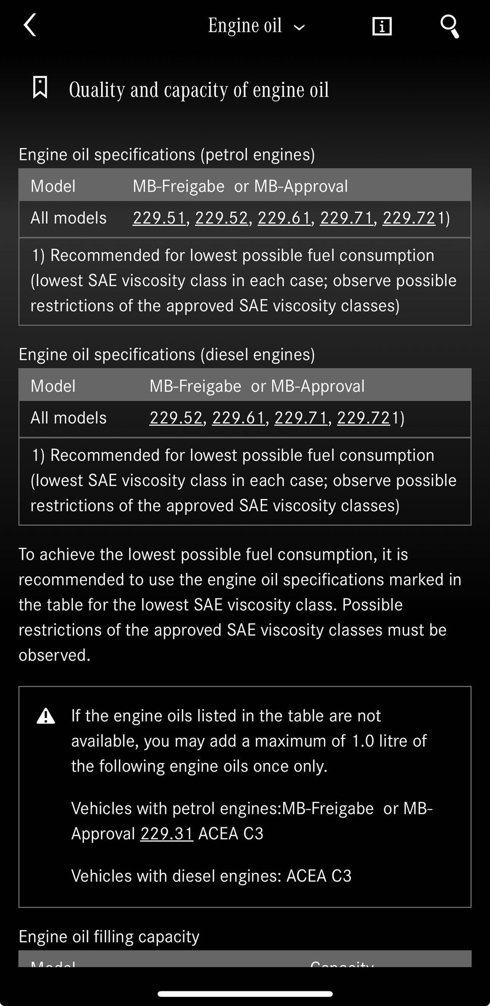

Hi guys,
I would like to confirm if this oil: Pennzoil Platinum Euro LX Full Synthetic 0W-30 Motor Oil a good oil and safe to use on my new 2023 model year C43 coupe (about 1000km on millage). My user manual specifies the need for oil with at least MB approval 229.51 (instead of 229.5 which is weird). And in Canada, it is difficult to find a 229.51 approved oil in 0W40 grade. While I'm know that Mobil 1 0W40 is a recommended option, it only meets the 229.5 standard. However, on the Pennzoil bottle, I can see
it mentions it meets both 229.51 and 229.52 MB approvals.
