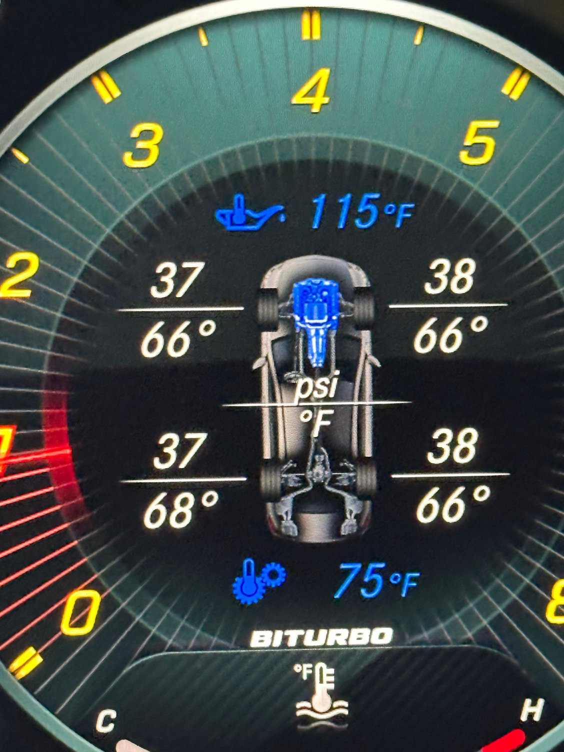

So after clearing the codes (was able to clear all the codes listed in my earlier post, with the expection of U012287), I have not had any codes resurfaced.
Does anyone know what U012287 is attempting to flag? I am unable to clear this code and from many posts on this site and other forums it seems to point to the AMG drive unit but am unsure.
Link to similar post (W205C43PFL you had mentioned that this poster had some rodent infestation I am unsure that this was the case as the solution was to unplug/replug the drive unit): https://mbworld.org/forums/c450-c43-...o-codes-3.html
Furthermore, please find attached images of tire pressure ratings and currently cold pressures in images below.
Am I right to say that the car should be 42 PSI cold fronts and 33 PSI cold backs given R18?

Sorry, it was this thread: https://mbworld.org/forums/c450-c43-...edan-w-pe.htmlOriginally Posted by cpisog
Hey,So after clearing the codes (was able to clear all the codes listed in my earlier post, with the expection of U012287), I have not had any codes resurfaced.
https://cimg4.ibsrv.net/gimg/www.mbw...d14351948.jpeg
https://cimg8.ibsrv.net/gimg/www.mbw...2f12542e0.jpeg
As for the tire pressures, there is a problem though. It is inconsistent, see this thread: https://mbworld.org/forums/c450-c43-...ml#post8137774
