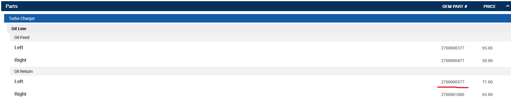

Went into the dealership for B service today at about 77,800 miles. They said the turbos have supply and return oil lines, and the driver's side return line is weeping/leaking at the connection to the engine. Repair was quoted at $1,900 and at that price, I imagine it's 95% labor and 5% parts. Before I bite the bullet, maybe someone here has done that repair and can generally describe all the things that need to come out to access that, and if any special tools are needed. I imagine it's probably a 4 or 6 hour job on the book, I would hope I could get it done in a weekend??

Mind you the above is for a 2020 c43... but FCPEuro shows fitment for 2017 as well.
These lines have o-rings which might be all you need? If it was me, id just get a new part.
Seems straight forward. I'd take on the challenge if it was me.
