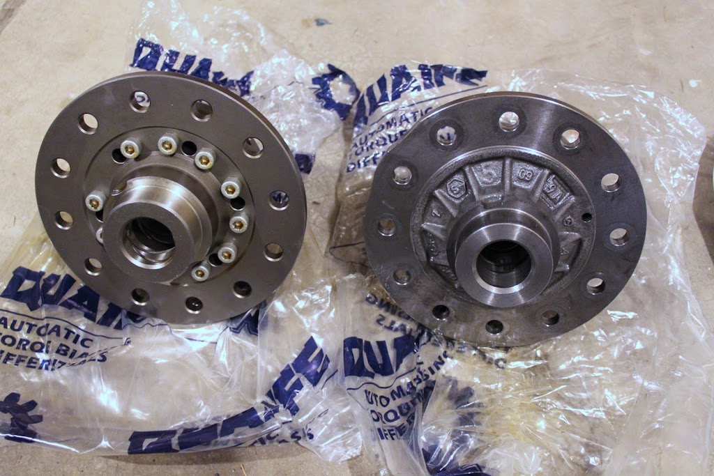

I took some quick photos of the Quaife QDF9V ATB Differential compared to the OEM unit during my install. I also weighed each of the units. The Quaife unit is approximately 3.5 lbs heavier than the OEM unit.
Quick Note: Besides the LSD unit, you'll need the following OEM parts to successfully complete the install on a C63.
Qty 2 - MBZ 230 997 03 46 (Mercedes Benz Seal Ring - Interior Flange)
Qty 2 - MBZ 001 989 17 03 10 (Mercedes Benz OEM Differential Fluid)
Qty 1 - MBZ 003 989 98 20 10 (Mercedes Benz Sealant)
Much thanks to James@ACGSD for providing a great deal on the LSDs and a simple parts list/install kit for the installs. You've got four very happy customers up in the PNW.
Quaife (Left) and OEM (Right)
Quaife ~19.5 lbs
OEM ~16.0 lbs

Out of curiosity...anyone know why the OEM diff has two flat spots...is that to balance it...don't believe I have ever noticed that before..

r u sure that is a oem lsd? looks like to me that is a open diff!
I never mentioned an OEM LSD. Not sure where you got that.
the empty looking one is stock for sure! I did the same mod on my GTI
the Quaife ones look closed.
but mine was a ATB so... I'm not sure if its a ATB or a 1.5way??
