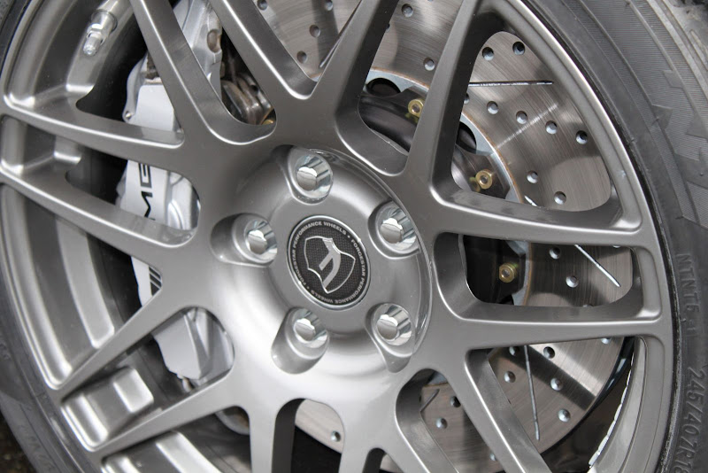

I'm using the Gorilla Automotive 17018SD-20 - Small Diameter Lug Bolt Kit
  • Thread Size: 14mm x 1.50 RH
  • Lug Bolt Seat Style: Conical seat
  • Lug Bolt Head Style: Tuner standard
  • Lug Bolt Material: Steel
  • Lug Bolt Finish: Chrome
  • Quantity: Sold as a set of 20.
  • Lug Bolt Thread Length (in): 1.000 in.
  • Wrench Size Required (in): 3/4 and 13/16 in
No issues with my Forgestar wheels. Currently torqued to 96 ft/lbs.
Like most aftermarket wheels, you should't run the OEM ball-seat bolts, you need cone-seat. Verify compatibility before you buy!
