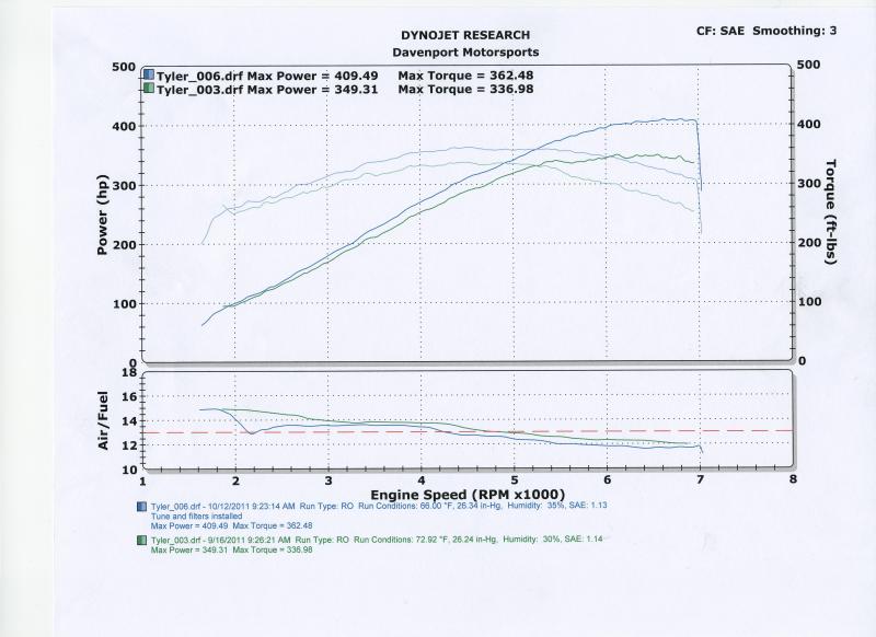

I did a dyno a few days before I sent the ecu out and about a week after i got it back to let the car "adapt".
The car feels totally different and sounds amazing. Couldn't be happier...
Stock - 349whp
Tuned with CD and K&N Filters - 409 whp
I lost 22% drivetrain so with the tune it puts the car at 524hp.
Here's the sheet.

Nice, so the tune file is actually richer at WOT (<12)?

Interesting numbers my original Eurocharged tune (V2?) dyno'd 415/373 on a DynoJet right after it was flashed, CDs removed stock filters. Graphs are very similar. The new V3 feels stronger now that I've been able to run it a little in "cooler" weather (70 -75). I guess I have to get to the dyno again to quantify the numbers. Anywho this is the best money I've ever spent on any mod to any of my cars.
