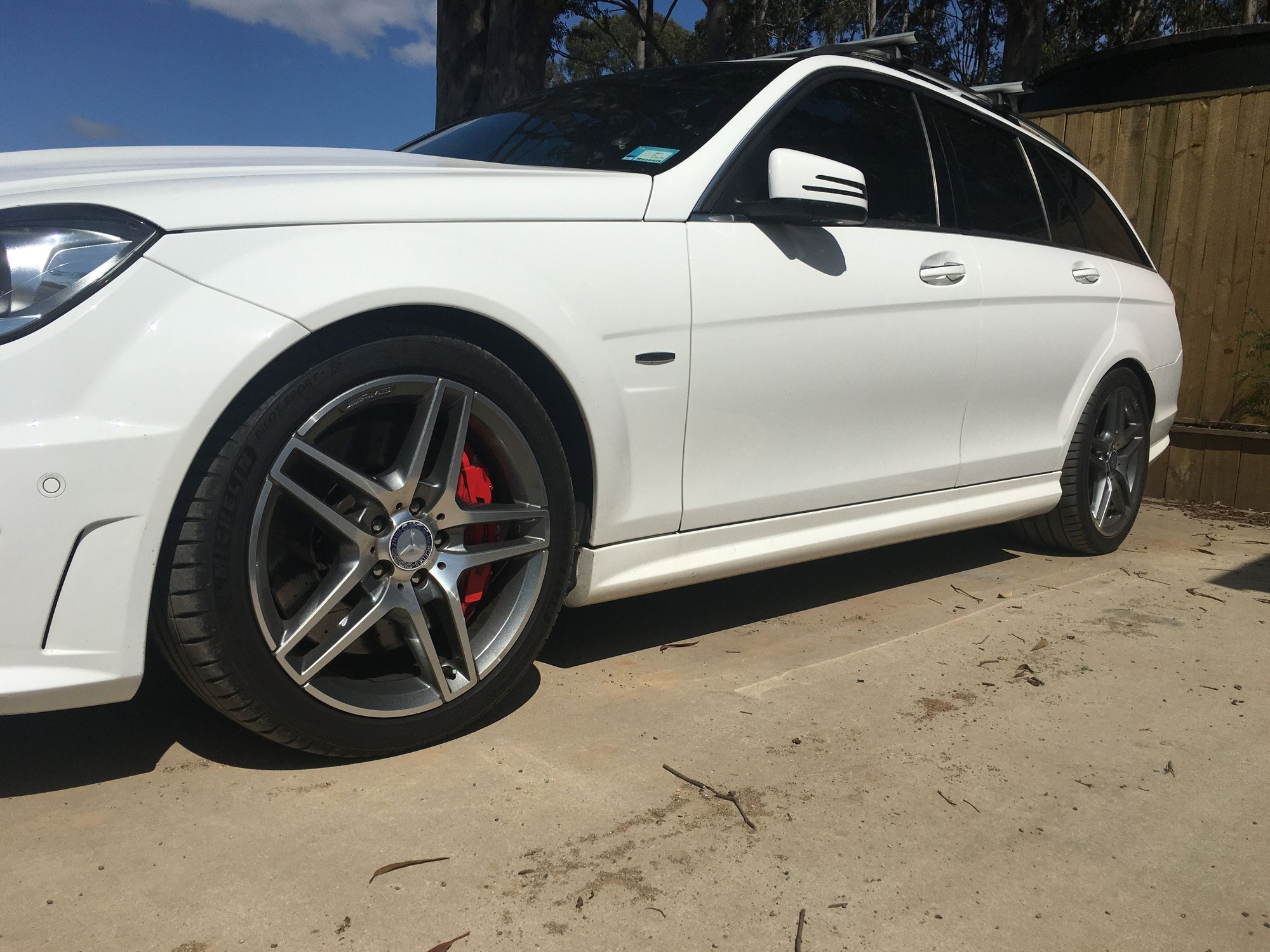

Originally Posted by fortytwo
Weird, I rubbed with 275. Switched back to 265s.
I'm running E400 wheels with same size and ET 18x9 ET56 and a 5mm spacer with Michelin PS4 275/35x18 on an estate with stock suspension.
