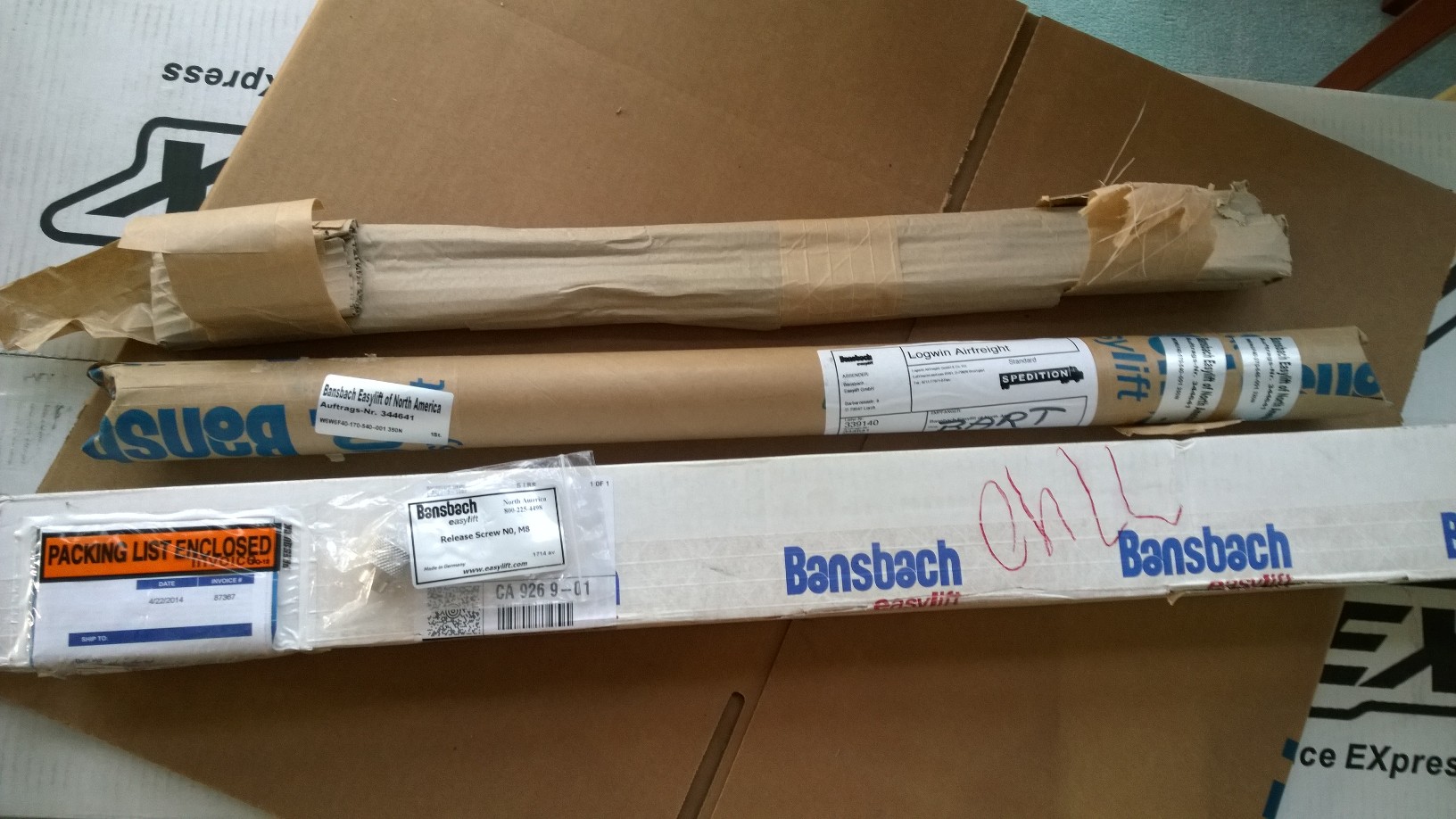

Long ago I started on a quest to find gas springs that would be optimized for a lightweight hood. I bought a number from several different sources but nothing worked out. After returning the last bunch of four to Grainger I called every manufacturer of OE fitment gas springs that I could find. I struck out with all of them...except Bansbach (manufacturers of the EasyLift line).
To make a long story short, an aerospace engineer in Bansbach's FL facility took pity on me and started working with me to spec a set of gas springs for the C63. Some months later, the prototypes are here from Germany. This set utilizes a release screw so I can incrementally bleed off pressure to find the ideal pressure. The factory will then build a custom set for me. Yup, all that work and effort just for me.
If you are interested in a set for your own car please post a reply here. I'm a few weeks away from the trial fitting and am not opening the package until then. The photo shows my OE gas springs and the new Bansbach replacement still packaged. I'll post followup photos. Bansbach has provided me with pricing for a quantity (one shot) purchase. Amazingly, it's lower than the OE gas springs at discount internet pricing. This would not be run as a group buy (i.e., I will NOT be sending them out), but I'll work on having Bansbach or Grainger handling the lot and providing direct fulfillment services. I'll update this thread in a few weeks.

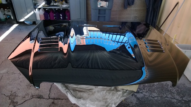

Here's the hood, painted.
Attached Thumbnails Please read if you are using a CF or other lightweight hood-cf-hood_1.jpg   Please read if you are using a CF or other lightweight hood-cf-hood_2.jpg

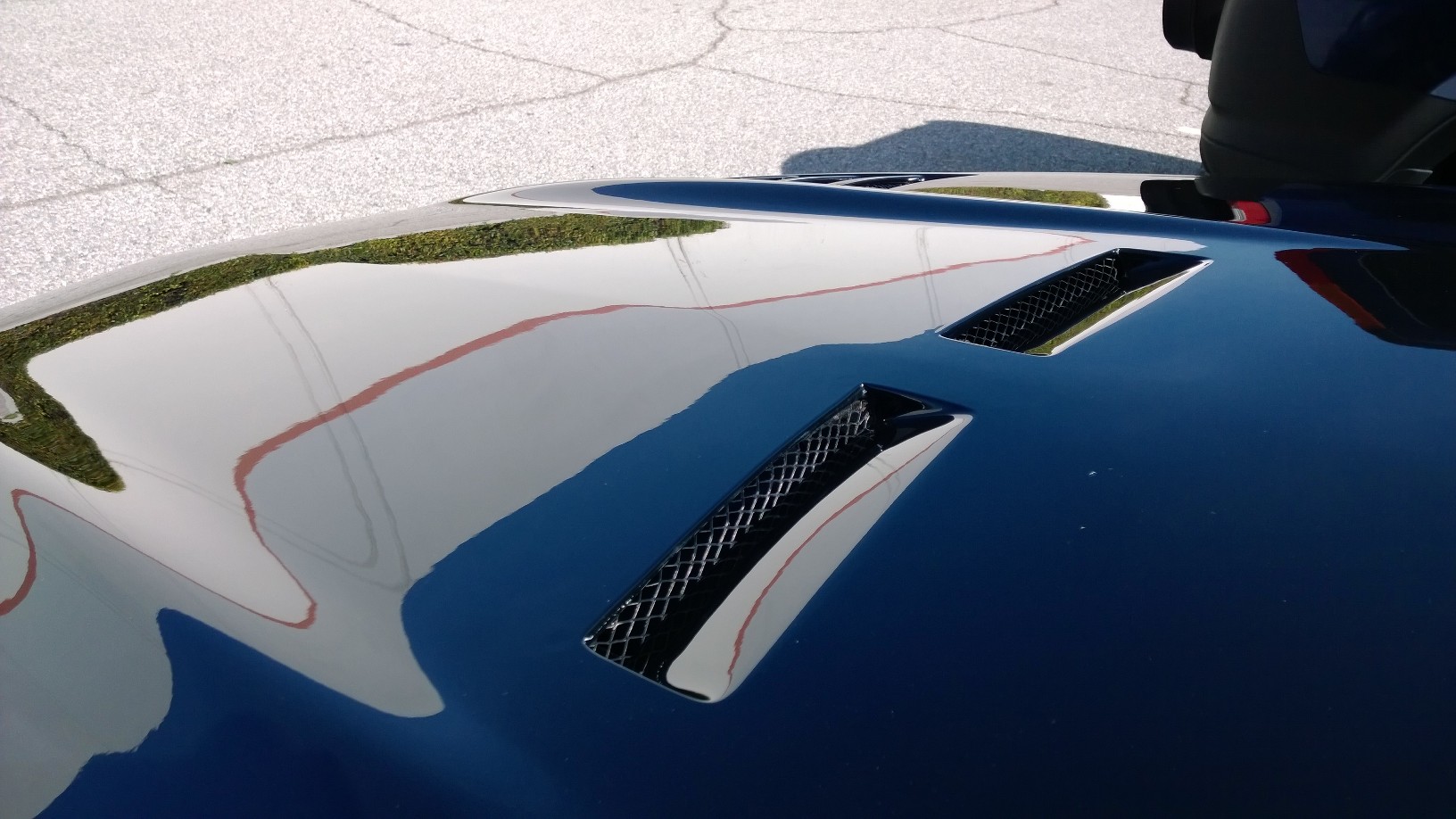

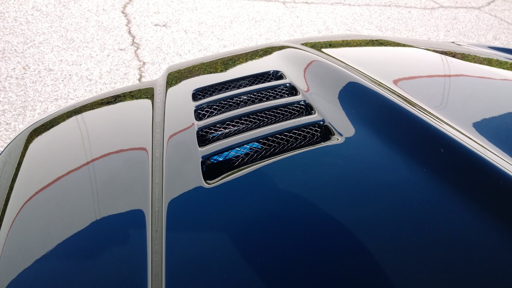

Two more very low res.
Attached Thumbnails Please read if you are using a CF or other lightweight hood-wp_20140213_12_07_10_raw.jpg   Please read if you are using a CF or other lightweight hood-wp_20140213_12_07_18_raw.jpg
