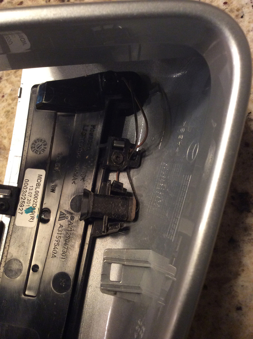

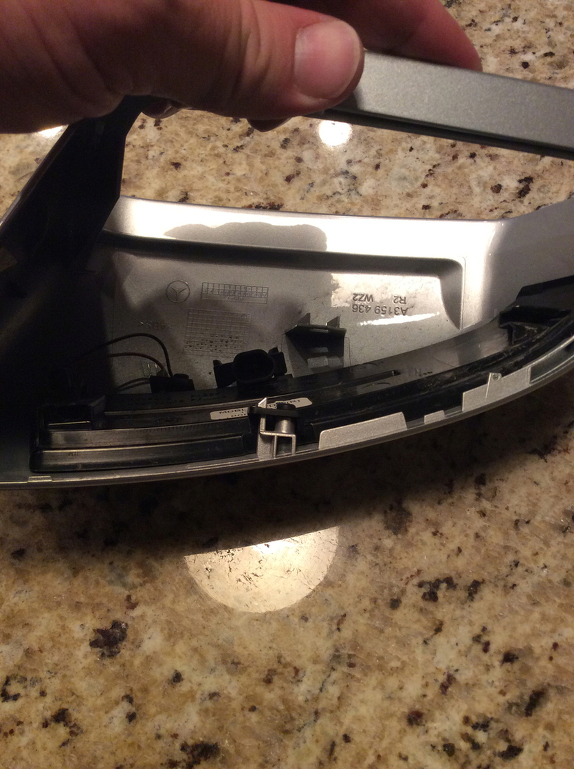

So after taking off the mirror cover I believe it is possible to reuse the LED blinker arrows. Here are some pics below:
After taking off the mirror cap per the above instructions (video) the LED strip has two T10 star screws and two tabs holding it in place (the black plastic strip is the back of the LED strip):
Side Mirror Arrow LED turn signal removal-152b17d06a0b7e95b3422e9ae788b80d.jpg
Bottom up view:
Side Mirror Arrow LED turn signal removal-961d4f9201fd7c3a9bec115b9fc57610.jpg
One more view:
Side Mirror Arrow LED turn signal removal-ab0baf531f7a70233cd5fa7e96d87204.jpg
Remove the screws and the tabs should easily pop out. The issue is that the small middle portion of the mirror cover looks to be actually glued to the LED strip (top skinny portion of the mirror cover).
You can see where it is sticking better from this angle:
Side Mirror Arrow LED turn signal removal-315c2f873efc7d7df23c2486b75035d0.jpg
I pried and worked it a little bit and I think I was getting the adhesive to give a little. (I didn't want to risk breaking it as I don't have my new mirror covers yet.) I'm sure a few minutes with a hair dryer would do wonders. It looks like the LEDs should then pop out.

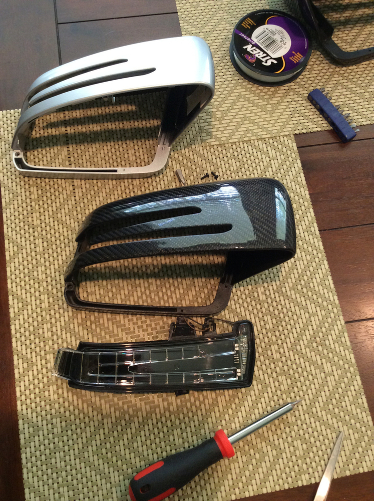

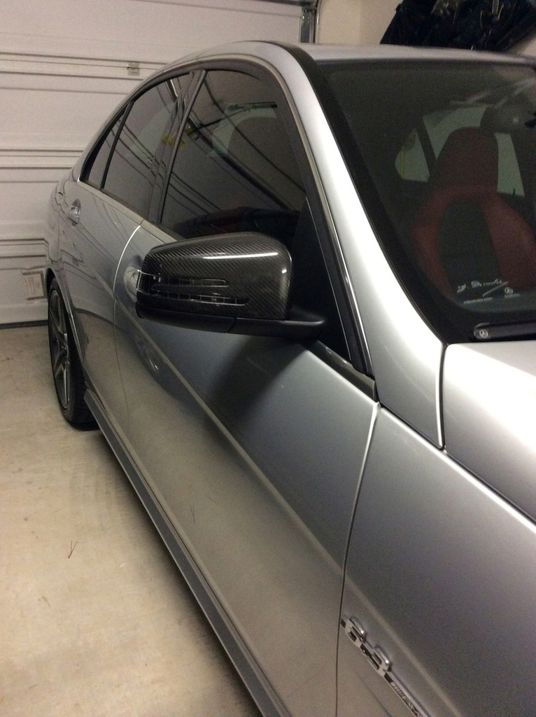

Well, my carbon fiber covers came in this past week so I decided to put them on today. Overall, it was fairly simple, only complicated by a little bit of work with the dremel. I ordered the cheapest set of actual "covers" I could find on ebay that I was able to confirm was OEM equivalent. Well, they weren't quite OEM fit, but close enough considering I only paid $138 shipped for the set. Fit and finish is quite good as well for the $$.
Overall, I'm very happy with how they turned out!
