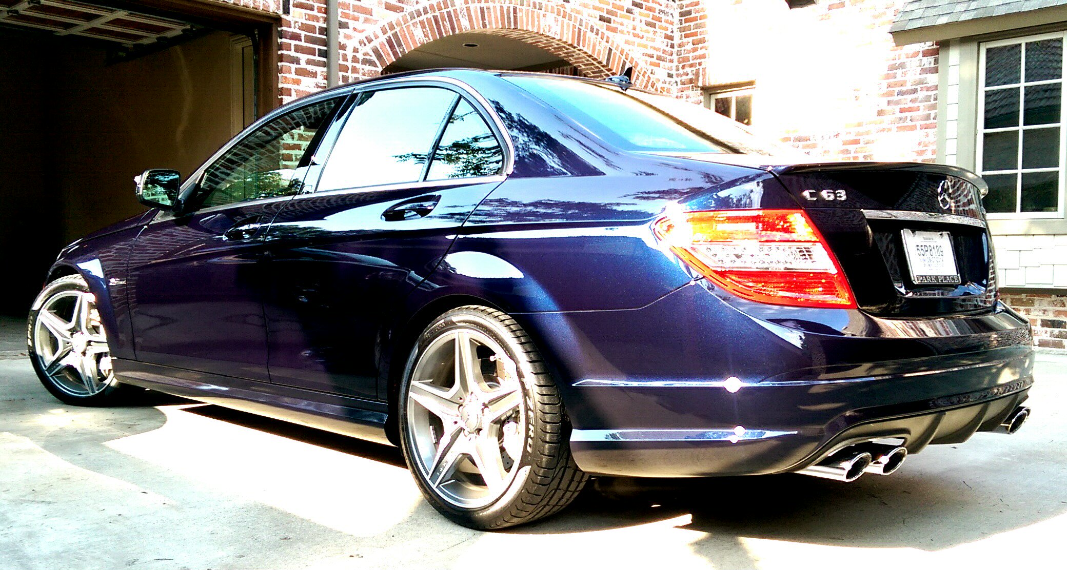

What is Capri Blue? Is it a light blue or a dark blue similar to the Lunar Blue of later years?
Old Aug 1, 2014 | 03:00 PM
johnny--2k's Avatar
Joined: Jan 2003
Posts: 675
From: Dallas, TX
2018 GLS 550
Here is an image of the build sheet and a pic for color reference
Attached Thumbnails New Owner w/ a question-imag1760.jpg   New Owner w/ a question-imag1750_1.jpg

The color is gorgeous. Great find. That's rare.
Old Aug 3, 2014 | 06:07 PM
johnny--2k's Avatar
Joined: Jan 2003
Posts: 675
From: Dallas, TX
2018 GLS 550
Thank you! Seems like its an all around odd combo of color and equipment!
