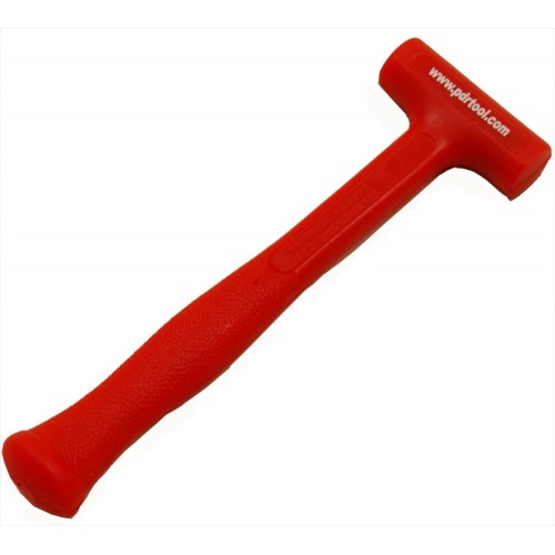

I fix damage like this day in day out. Don't listen to anyone else, this damage is 150% PDR all day
You need this hammer. In the hands of someone who knows what they are doing will sort your door egde out in 2 mins, with NO paint damage.
The high ridge line just needs to be carefully managed and will disappear.

That pliers tool above will cause a mess in no time.
Just call a PDR company.
