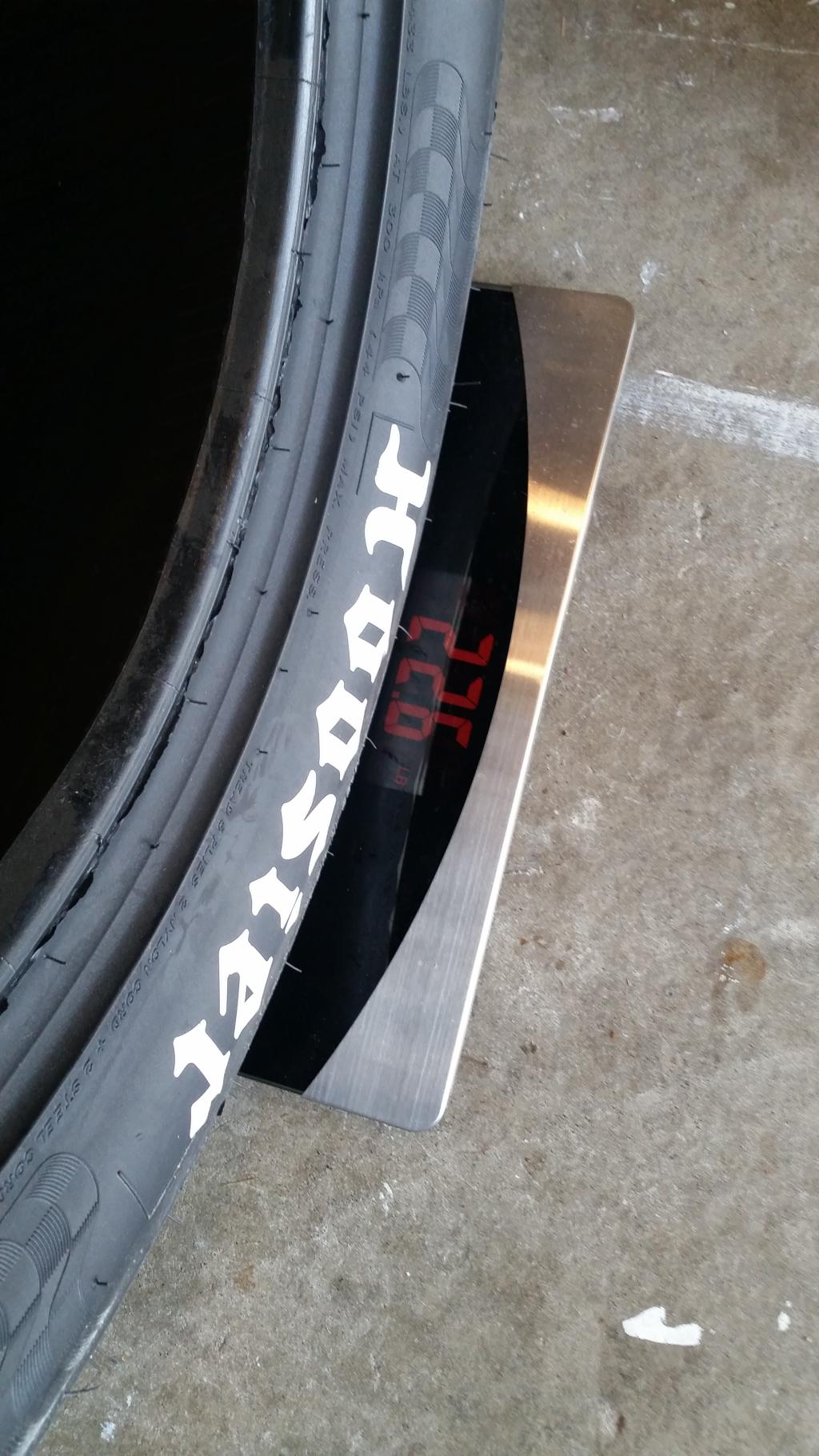

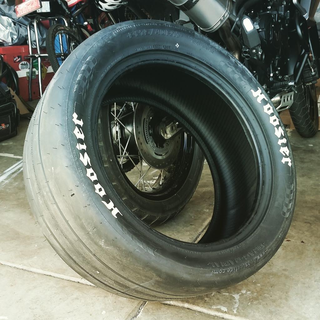

Trying to choose my SLICKS-20150302_130842.jpg[/URL]

Originally Posted by rpurdy210
the Nitto NT01 is a fantastic track tire and cost about half what the Hoosiers do. they arent R compound, but are extremely sticky, and will last a lot longer than the Hoosiers. I have had them on several of my track cars and love them, the guys at my track day groups all feel the same way. if money is no object, go for the Hoosiers, but these are a great option
I was looking at those for track days (road course), but since this is just for the drag strip I wanted the all or nothing drag radial race tire.
If I could have dropped down to a 16 without modding my rear brakes and/or spending huge money on custom wheels I would have definitely went for a bigger sidewall, this is pretty much the max size I can run on 17's. I didn't want to switch to a 28" tall tire as I think that will bog off the line.
I haven't touched the rear end yet, but this summer the modding will continue with an LSD and probably some weistec axles. I haven't heard any horror stories of breaking driveshafts or axles yet, at least not without a supercharger or without launch control (which I don't have anyway). Going to be preloading the drivetrain vs just smashing it off the line to take as much shock out of it as possible.

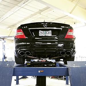

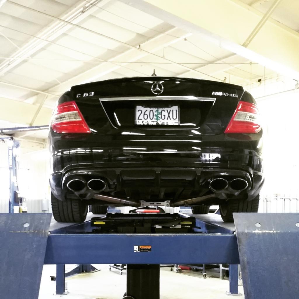

Fingers are crossed, had her on the lift for an oil change and a minor tune up yesterday. Having access to a lift and tools for $8 is such a lifesaver. Helps me keep the maintenance costs in check, and gives that satisfaction of doing all the work myself.
Couldn't be more excited.

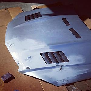

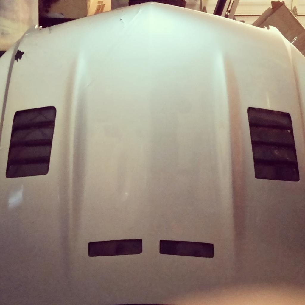

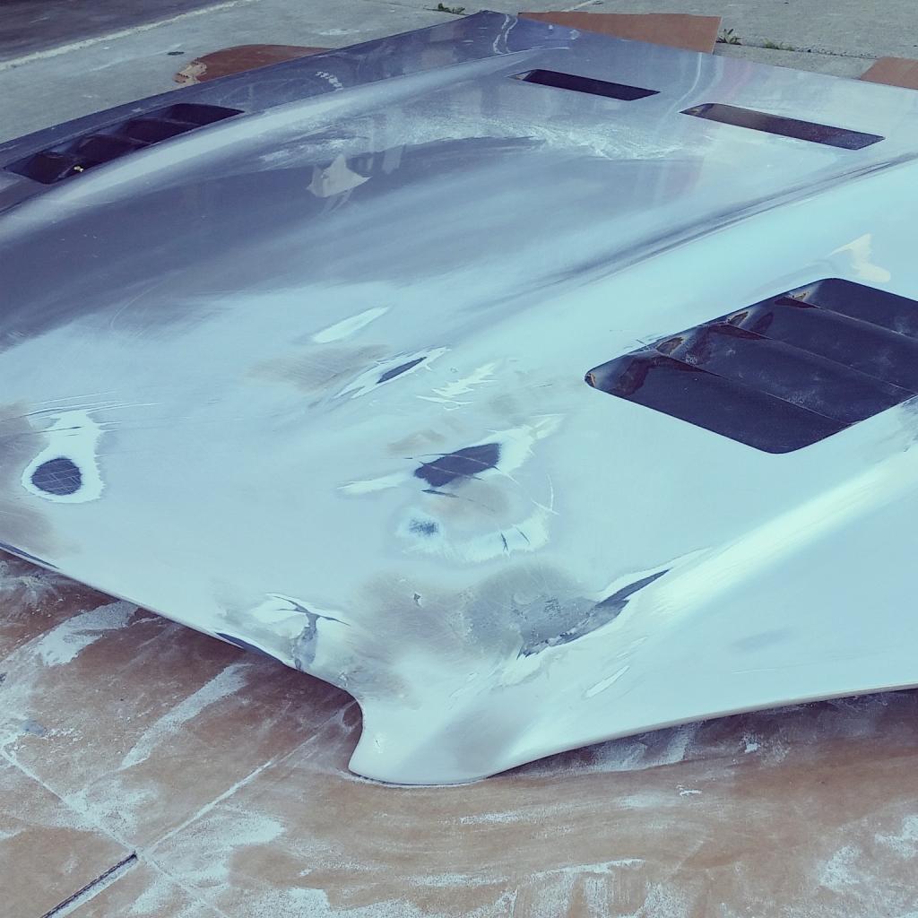

So I guess this went from which slicks to get to a kind of small drag strip build thread. Picked up a shattered/cracked DadsC63 CF hood on here from a member pretty cheap, and was planning on running as is for the track, well...I started messing around with it yesterday and here is what happened...
Old Mar 8, 2015 | 01:34 PM

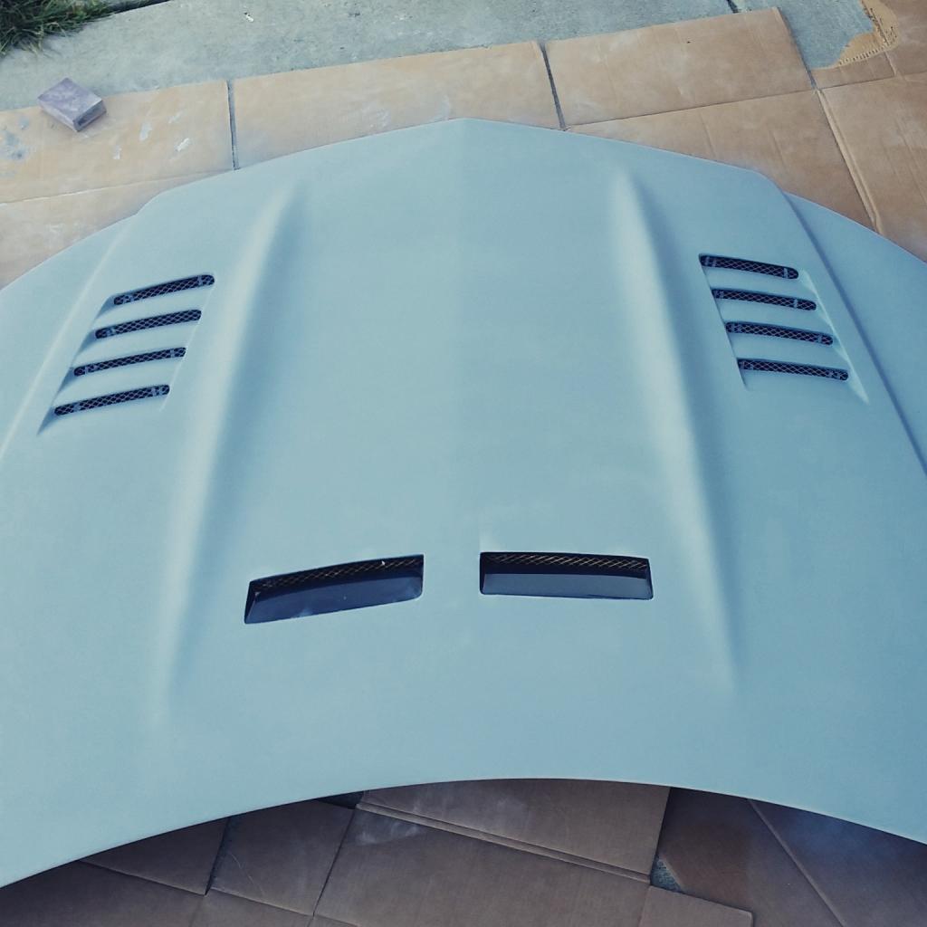

And after hours of sanding and fiberglass and primer and more sanding...have a sweet plan for the track only hood which you will all see shortly...this has really become quite a fun and interesting build.

Thank you, that was actually my first time doing bodywork. I like to think I'm mechanically inclined, which is good since I'm an aircraft mechanic, but that was my first time dealing with fiberglass and leveling it out smooth enough to paint. Quite the experience!

You are going to switch hoods every time you go to the track?
Hood looks great by the way, I would go matt black hood and keep it.
Old Mar 9, 2015 | 10:30 AM
  #43
C63TSgt's Avatar
Joined: Sep 2014
Posts: 160
From: Suisun City, CA
2009 C63
Yeah. I got an extra set of latches and so the switch is easy with the help from a friend. It will be matte black actually, after I get off work tonight anyway. Just with a little twist...more on that later.

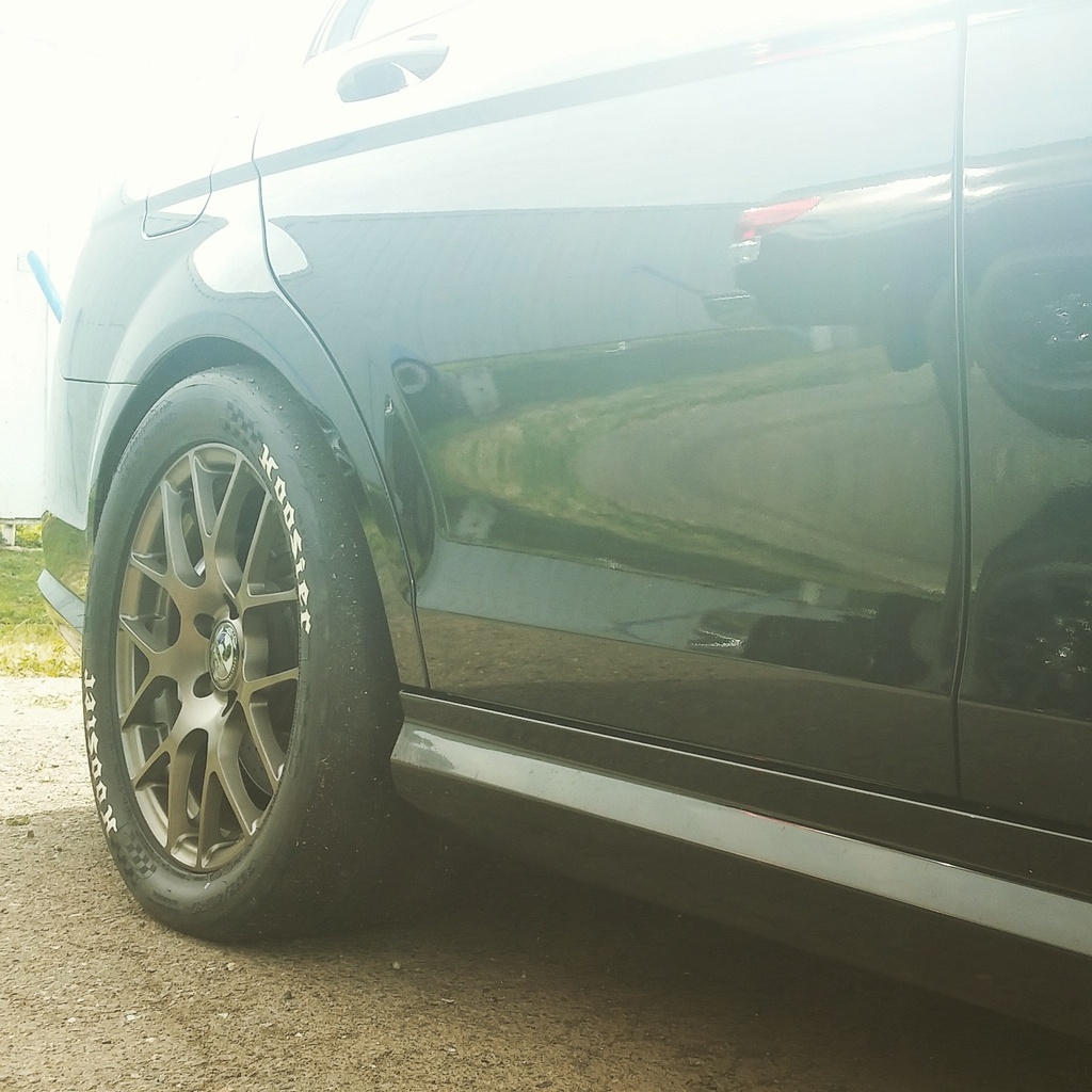

New coil is in, so I guess we will see how it goes. The track prep was garbage and there was light rain all day to include a few times while in the pits, but 1.8 60ft was no problem, I'd say that really says a lot about them. EXTREMELY HAPPY with that purchase.
