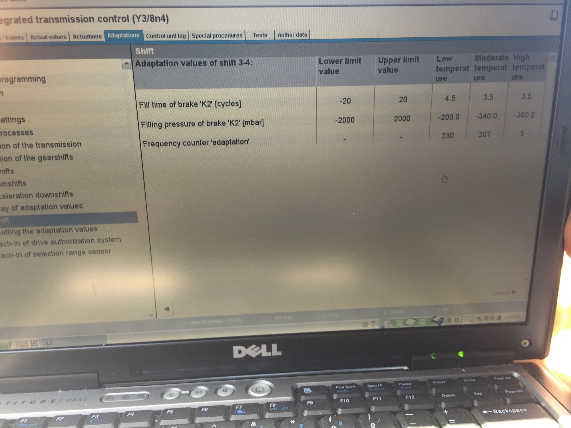

what are you adaptation fill times at for the 3-4 shift. The strangest part of this is that it's only in manual mode. I dont really have any good suggestions other than pull the valve body out and check for clogs and crap build up on the screens of the shift solenoids. make sure the fluid level is correct. How long has this been occuring - is it only since you serviced it a week or so ago? post a video of what its doing.

This stuff is all French to me.
It did it once at the track a long time ago and I think since I did the service, it has been 99% worse, happening almost every 3-4 shift in m mode only.

the filltime is mostly what your looking at and the different temperatures. -20 to +20 is the range. Anytime you start getting getting really high or low there is probably a mechanical issue. Yours are almost 0 which means its probably not a mechanical problem. typically a good transmission will be in the -5 to +5 range on average. When my 3-4 shift was slipping like crazy under full throttle on the stock transmission and had values around 15-18 for fill time - just to give you an example. The more positive means it is having to apply alot more to grab - typically associated with a loose tolerance or possible leaking seal. The negative value meaning it is taking less to apply then it is expecting - like too tight of a tolerance, maybe a broken peice or friction compound that has come apart and stacked up on itself. The different termpatures - obviously show if it's temperature related - so possible clearance problem with a sticking check ball or spring depending on temp. considering it's only an issue in manual mode im going to say its an electronic/tune problem. As I think all of us modified guys know. It's tough for the tuners to dial the cars in perfect without them being there in person. Fluid check would definitely be the top priority but it wouldnt really explain why it only does it in manual. That is strange, it's almost like its limiting the power / torque so the motor doesnt hurt the transmission.

No I haven't touched anything. So my values in that screen shot look normal, that's good.
It does seem like a electronic/tune issue to me, whether it's ME or TCU I am not sure...
I will check fluid soon.
I agree it does feel like it limiting torque then shifting. I can hear it bleeding boost as it closes the throttles between the shift.
