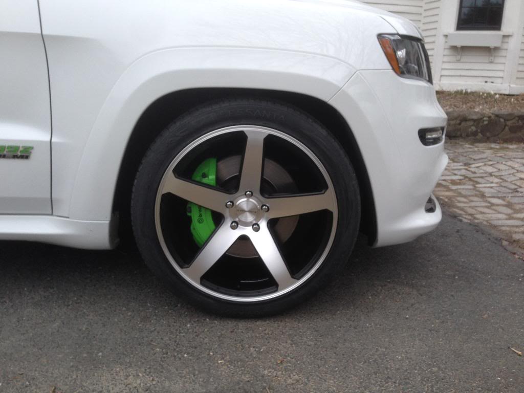

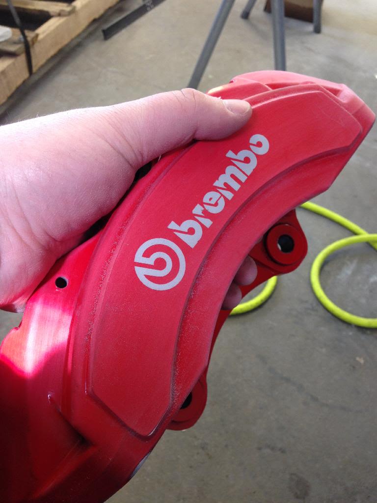

all you really need to do is take the bleeders off and make sure they are drained completely. no need to completely disassemble and remove the pistons. just mask them off. I did the brakes on my srt8 jeep they came out flawless. just a light scuff
then right to paint
I didn't clear over the stickers because i was afraid of making a mess out of it. They were fine and are still fine.
