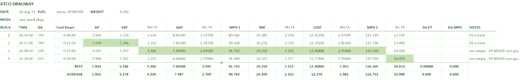

Ran the tank dry. Here's my spreadsheet.

Blkrokt,
thanks for sharing - that is a helpful data point!

Yeah, I am pedantic about data. Always have been - have all my runs for every car I've owned with DA, notes, etc on a spreadsheet going back to 2005. I like to know EXACTLY what changes/mods work and what doesn't work.
I don't know if I have a 113mph car, because those were the only passes I ran it on 93 octane. Every other pass was on 100 octane gas, and every other (22 total) was in the 116's.
Have seen similar results on race gas with my old 996TT, but of course boost changes everything...

What you have above is a spreadsheet of results that could be attributed to many variables.

Nice. 3 mph on MS109....isnt MS109 105 octane? I assume this was still stock as the mods list looks to be just plugs.

I understand what you are saying , although that data is also subject to interpretation and how each individual graph affect each other, or you could be missing some data point that you did not or could not measure. I enjoy the car by how it feels and how far it goes. Does not all that data secondary to just how the car drives.

Mike450, in case the chart you shared was intended to contribute to the question at hand - it is not legible. What does it show?
If not, then Blkrokt's spreadsheet is still the only actual datapoint in the thread.

What exactly are these "many variables" you speak of?
Same day, same mods, same conditions, runs done 18min apart. The only change was switching to race gas.
I would data log it next time at the track on Thu (first time this year with my winter mods), but I have exactly zero interest in running pump gas. Take it or leave it. I think there are enough people who support this, and enough real-world experience shared by others.

You are correct. Only changes I had made were plugs at that time from my prior runs.

What I posted is not a c63 dataview, only an example of what data you would use to evaluate a mod and it's effect on performance.
Data like shift points, timing, knk, iat's, MAP, clutch slip, etc ... all of which are variables that will determine how fast you get down a track and give you a view into why you ran what you ran.
Did your car shift at 7krpms in 1/2 or 3 gear, or did it shift at 6700? Did the TCM invoke torque management in 2nd gear? Did you have an unusual IAT on your first run that resulted in stKnk? Did your 113mph run see 4 degrees of STknk from a the not so-93 octane you were running?
You won't know any of that if you don't log, but you'll be faster/slower because of it. And most of it has nothing to do with fuel.
There are broad effects from the most minuscule variables that a PCM or TCM sees, that can results in significant changes during a measured event such as DR. That's all I'm trying to convey here, but I see some feathers are rustled. I apologize, that is not my intention.

Originally Posted by BLKROKT
3mph in the 1/4. Same day, same conditions. Only difference was Sunocco 93 pump vs VP109 100 octane unleaded. That's better than any data logging. Can't dispute real-world results. I'll dig up the slips and post them.
And the car certainly "feels" smoother, stronger, faster to me when I have it loaded up with race gas. These engines love it.
Not to be argumentative, but, even though times do not lie, you really can't claim that results on a given day/conditions and a result of a 3mph gain is consistent with switching gas.
I have ran the same car, back to back without changing a darn thing, and gotten different times/speeds...an awesome launch vs. a good launch again can yield differences of 0.2-0.4 seconds and traps of 3-5mph...
Just my 2 cents.
Carry on.
