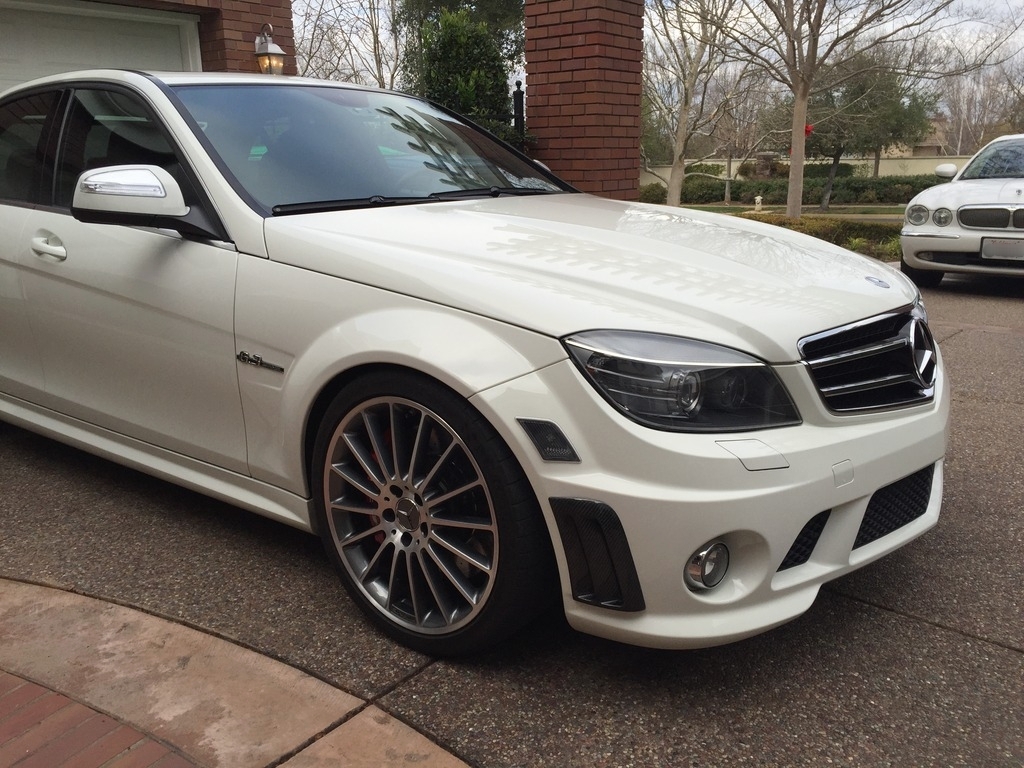

This is completely dependent on how low you want to go.
At stock height, you can probably go 12 in the front and 10 in the rear. I'm at 10 and slightly rub in the front. I'm at 5 in the rear and couldn't go any more aggressive if I'd like to do to how low I am.
