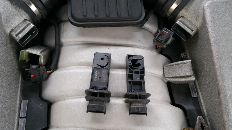

Just had a look and it seems as though the left MAF was fitted upside-down...is that normal?? Surely it can't be...the sensor clip would always be facing upwards for ease of removal. I know on other cars, fitting a MAF the wrong way can lead to all kinds of running issues...

This is the orientation of how they came out...

So yeah....pretty odd to me. I just gave them a good clean with carb cleaner and giving them a bit of time to dry now before refitting. I'm going to fit the left sensor in the same orientation as the right one...it just seems like the right way to do it. Fingers crossed it's something as simple as this as to why my car is so down on power. lol sods law though that it probably won't make even the slightest difference

they are supposed to be upside down on one side.do NOT put the other one in the same way or u will have issues.if you look at the sensor and see the opening where the air flows into it and see the direction of the air coming in from the airbox it will make sense to you why one is upside down.
if you put it in like the other side it will have the air port facing behind the airbox and not be able to read the incoming air.

lol, thanks man - i just just refitted them and came back to post but saw your message above.
Yeah there is a guide pin on the maf that means it can only go in one way anyway.
Damnit, well it was worth a try. I guess anyone would consider the same if their car is 40hp down after cams and a tune
Refitted and started ok. I'll pass judgement on the 'clean' later. Doubt it'll do anything tbh, but I may still buy a new pair of sensors just to rule it out.
