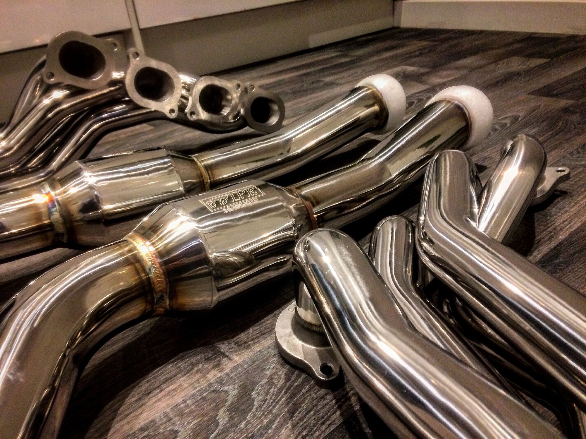

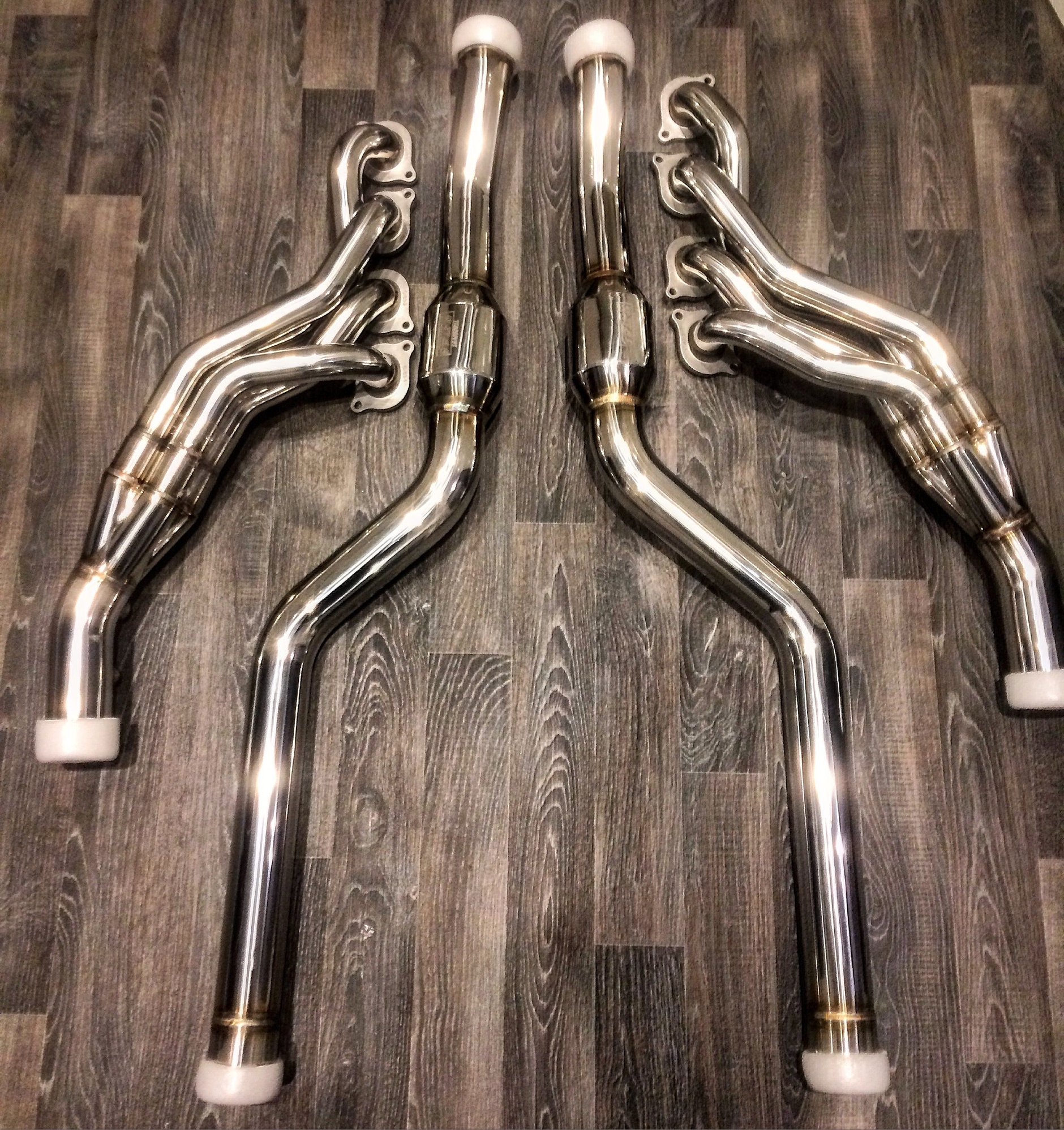

FWIW I just bought IPE headers from IPE Taiwan. I placed the order from here in the UK and they were with me within 10days including the weekend and customs.
I haven't fitted them yet but I'm impressed with the quality of the bends, welds and pipework. I opted for catted headers due to our yearly emissions (and sometimes on-the-spot roadside) checks and they look solid enough from what I can see to do the job.
They are a three-part design with sleeved collector. Personally I prefer it this way for freedom of adjustability while fitting, and it worked just fine on my buddies MK1 Ford Escort rally car which sees so much abuse. The collector then sleeves onto the down pipes and comes with new clamps, and the down pipes connect at the other end to the factory resonator using factory couplings.
Once I can my A into gear with Eurocharged, and have them send me a Headers tune, I'll install these later this month.
After the headache of dealing with IPE Europe, it was an absolute pleasure to deal with IPE Taiwan.
Same as what you experienced, I also received the headers very quickly after ordering them.
And they do look good. Welding is extremely neat.

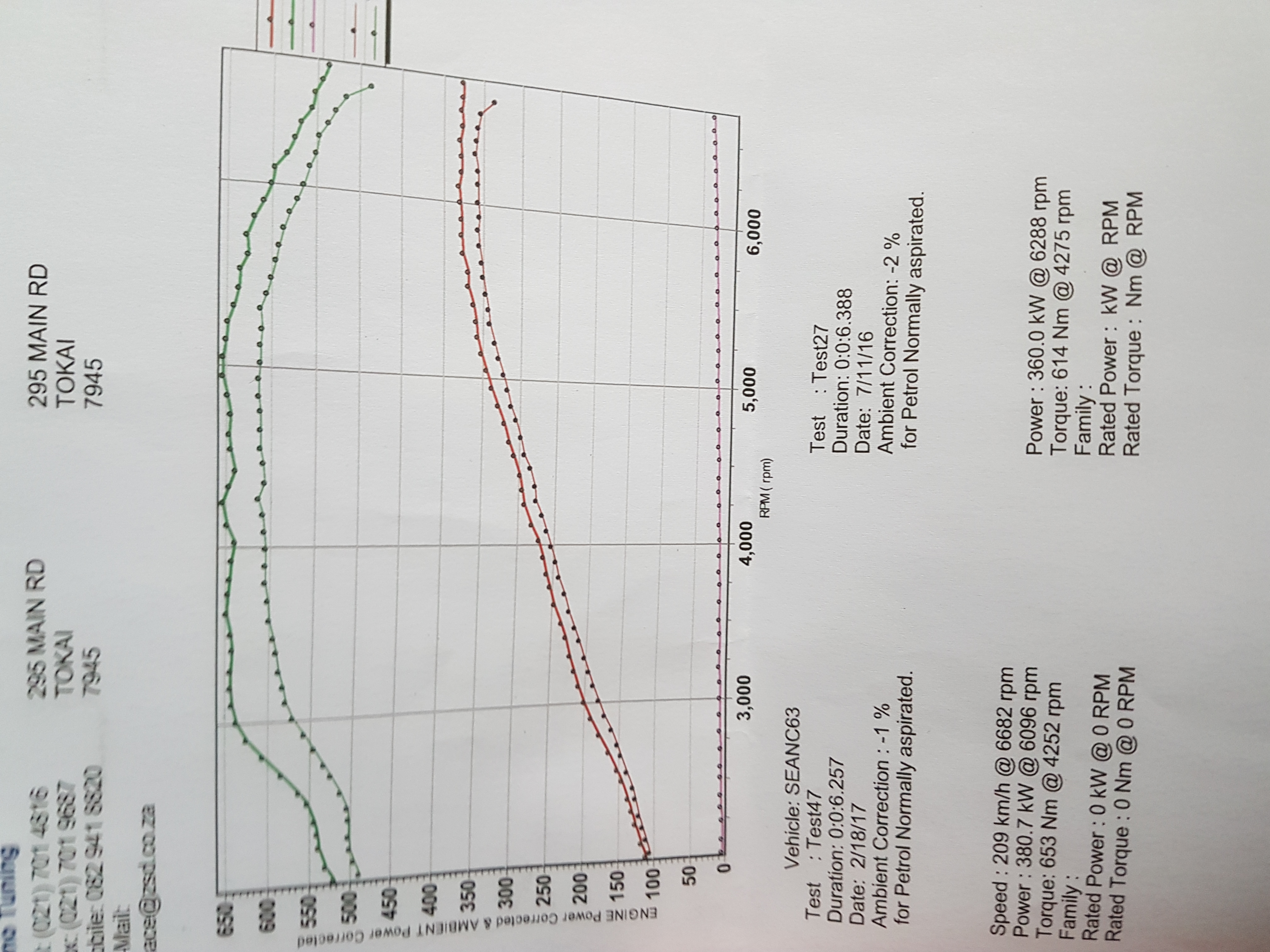

Initial results are looking very encouraging.
we loaded my previous tune file onto the ECU (which was tuned for primary and secondary cat delete, and resonator delete) and ran the car on the dyno. Stuck a lambda sensor in the exhaust just to check it wasn't lean or anything funny.
Then we did a power run. Car has picked up 13kW and 35Nm already.
We will start tuning on Monday with HPTuners.
Old Feb 13, 2017 | 08:04 AM
  #42

Tuning is finished. Picked up another 7kW and 4Nm.
So that is a total gain of 20kW and 39Nm over my previous best. Which was Primary and Secondary CAT delete, and resonator delete. Straight piped with tune.
Total gain from stock is 39kW and around 60 to 70Nm.
Old Feb 19, 2017 | 03:04 AM

Dyno graph.
Straight pipes (no CATS and no resonator) and tune vs IPE Headers and Mid pipes plus tune.
We made huge gains at the bottom by playing with the cam timing.
